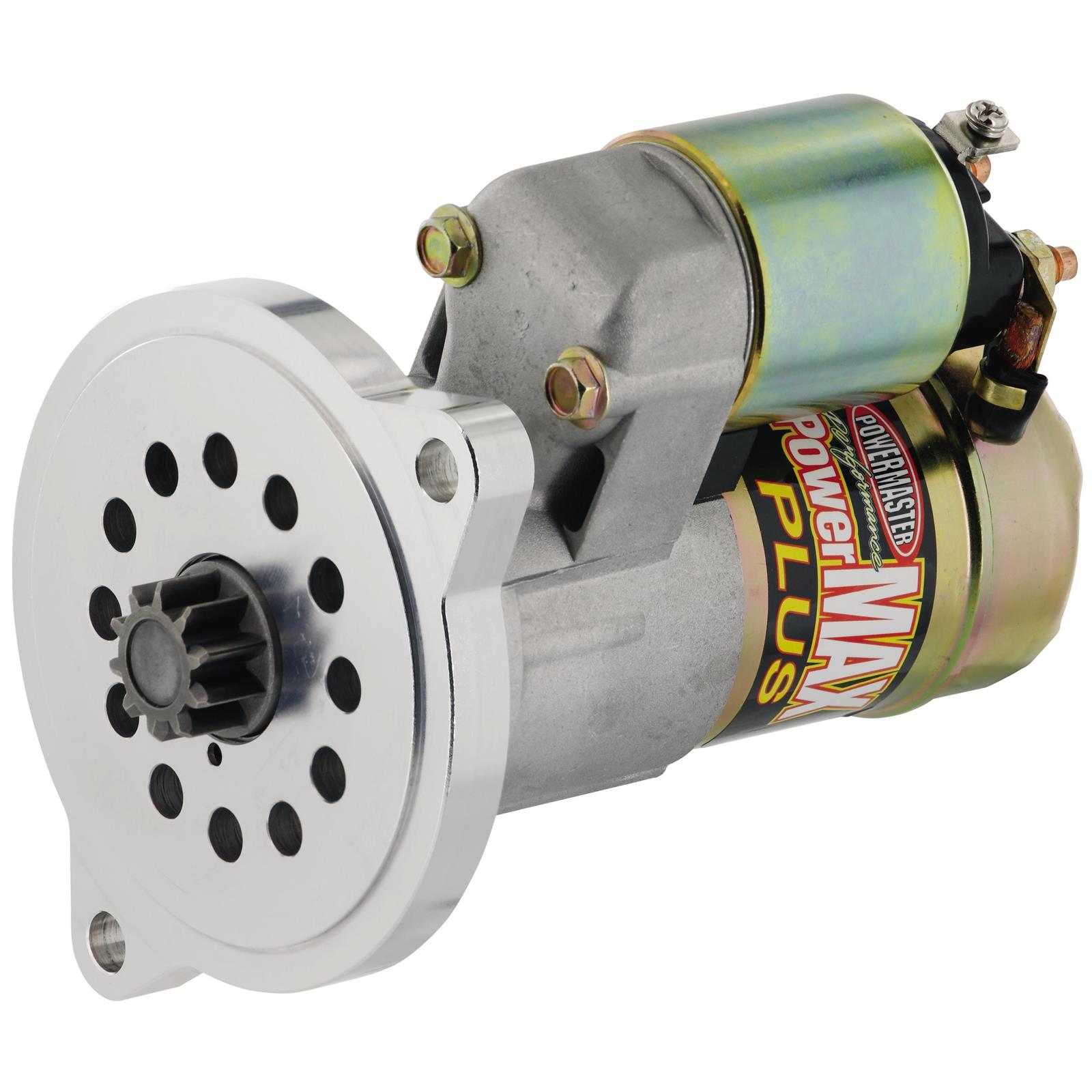

Powermaster 19103 PowerMAX Starter, Hitachi, Chrome, Ford $219.99
2 bolt
160 ft./lb. Torque
4.4-1 Gear Reduction
2 Mounting Holes
3/4in. Offset
Automatic and Manual 157-tooth/164-tooth (SB F0RD)
7.44 lbs
Ford 200ci Inline Six
Ford 221ci Small Block V8
Ford 240ci Inline Six
Ford 250ci Inline Six
Ford 255ci Small Block V8
Ford 260ci Small Block V8
Ford 289ci Small Block V8
Ford 3.8ci V6
Ford 300ci Inline Six
Ford 302ci Small Block V8
Ford 351C ci Small Block V8
Ford 351Cci Small Block V8
Ford 351Mci Small Block V8
Ford 4.2ci V6
Ford Boss 351 ci Small Block V8

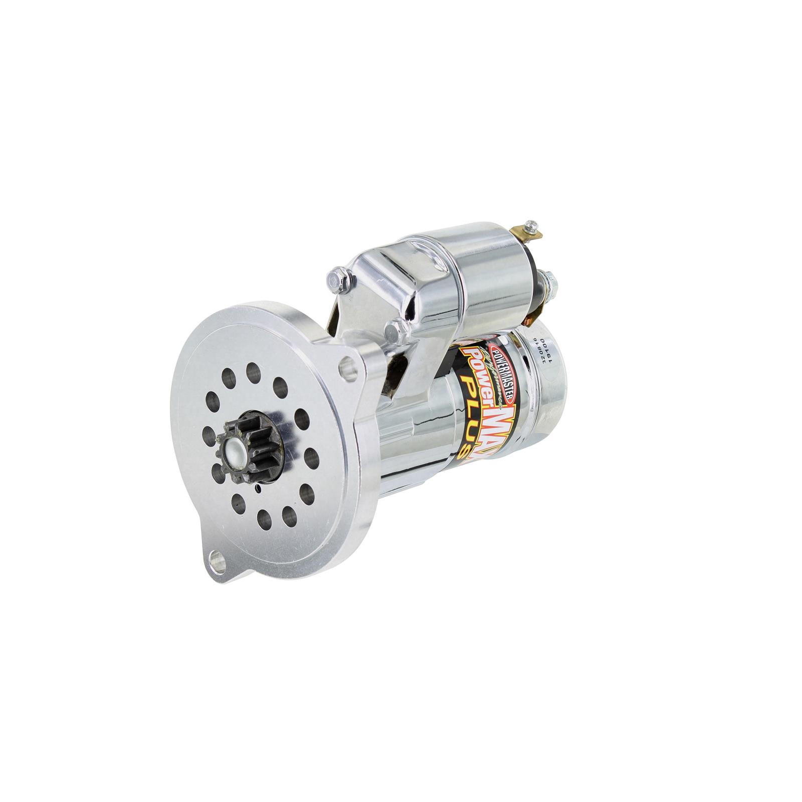

Powermaster 9103 PowerMax Starter $157.99
2 BOLT
6.1:1 gear reduction ratio and produces 160 ft. lbs. of torque
Fits Small Block Ford applications w/ 157T manual transmissions and 157/164T automatic transmission
4.08"starter registry hole and an adjustable mounting block
It is recommended for 10:1 compression ratio and weighs only 7.44 lbs.

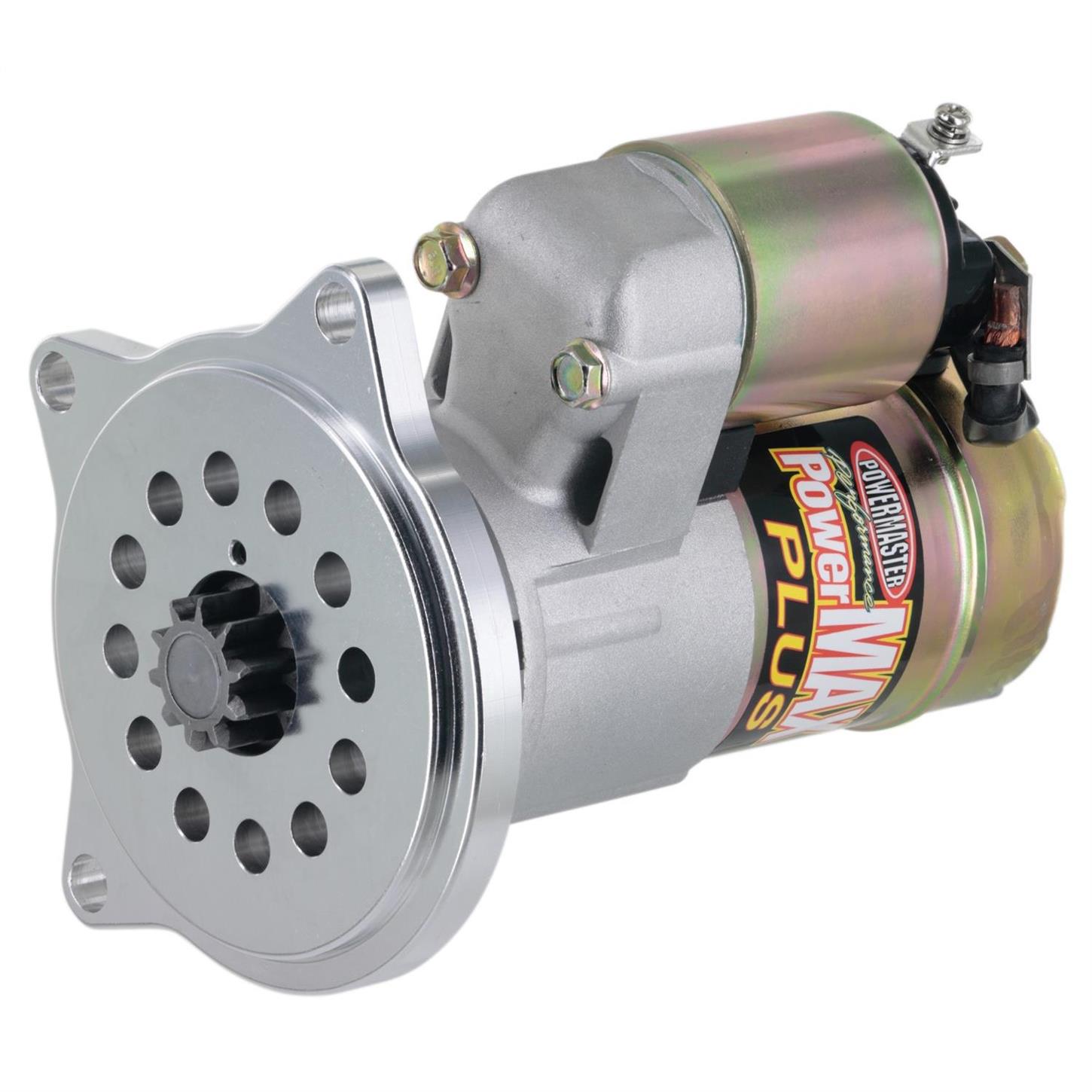

Powermaster 9106 PowerMAX Plus Starter, Ford FE, Natural $168.99
3 bolt
160 Ft/Lbs Torque
6:1 Gear Reduction
1.4 kW
1.7 HP
Natural Finish
Fits: 1963.5/1965-Up Ford FE, 184 tooth
