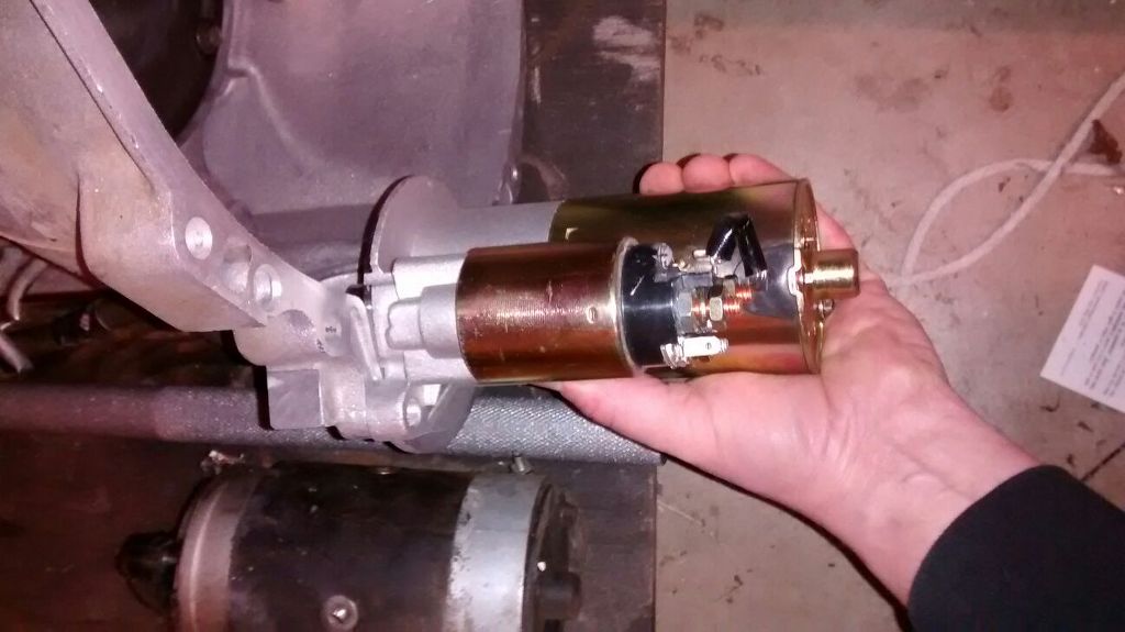

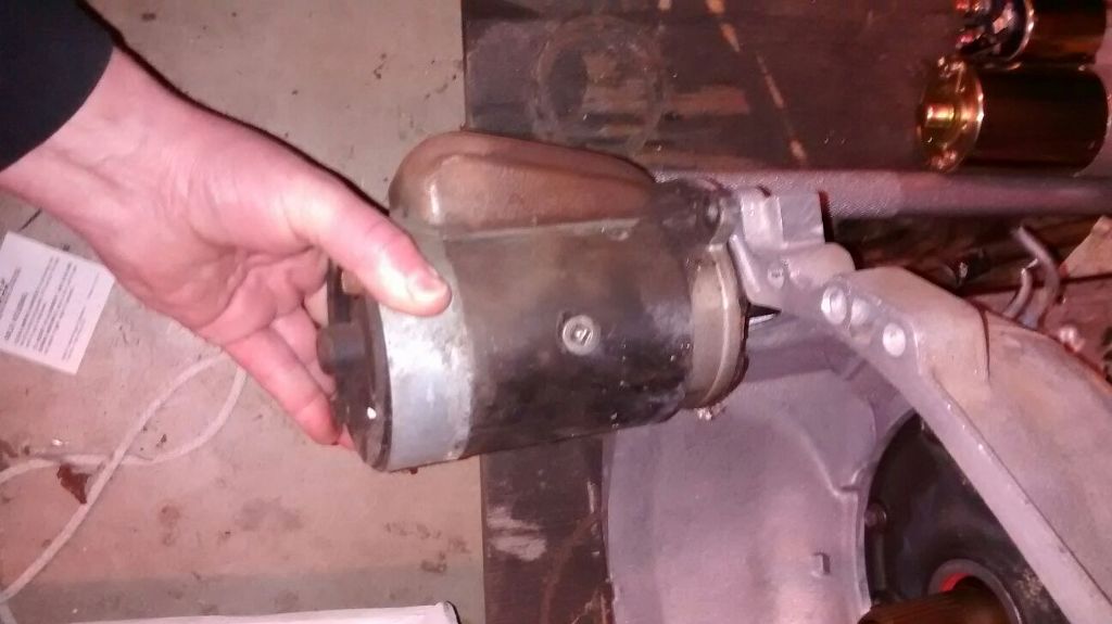

Econoline":2h5mqihf said:
I found these picture I took comparing the size of the old style vs the new style starters on my aod
Added some starter swap info above. i think it's most of it for the time being on block differance's, so if the site members will go over this info and let me know if any additional info needs to be added or the things that may need to be corrected, or rearranged for better clarity too. Then we could also add some more pictures. Thank you all for sharing your info and knowledge! :thumbup: :nod:
