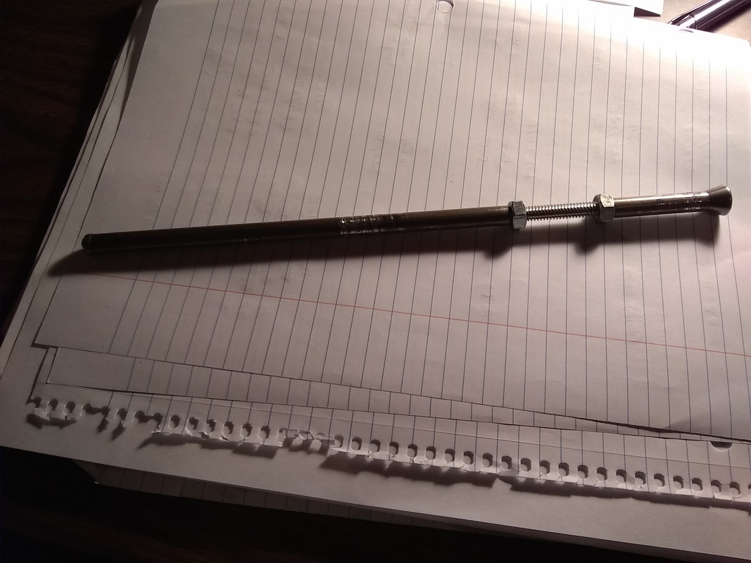

I use this on my Mopar slant six. Easy enough to make.
cup'n ball all right, but how'ja slip that threaded rod in the 2 prts?
