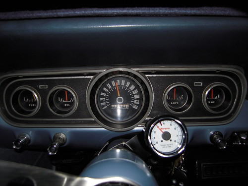

I recently installed a small aftermarket tach in my mustang just to see what the motor was doing while going down the road and so on. What I discovered has me puzzled.
I have noticed that this little 6 acts like a diesel motor. It shifts out of first gear at WOT at 3500rpm, then shifts to 3rd at 3000.
So, my question is: what is the normal redline of a stock 200 I6??? I know its got a tiny little carb on it, and a tiny little cam, but I can't imagine this thing only being able to spin to 3500 before nosing over like it does.
