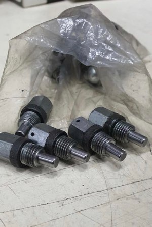

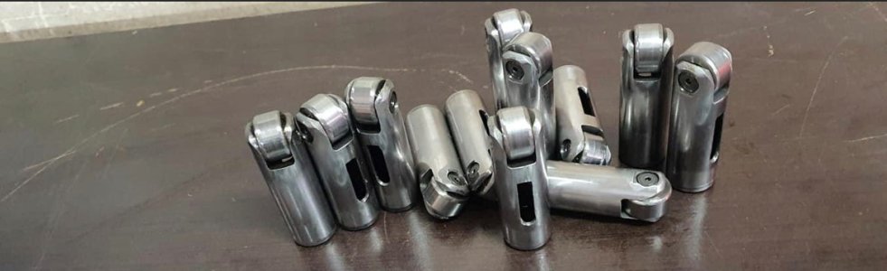

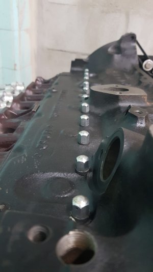

Down in Argentina they machine the side of the block with Key way lifters. See pictures.
Or what about something like these? Can they be made to be rotated to lock in keyway/lifter?

I measured from the outside to inside or the same as center to center of each cylinder pair of lifters at 2.100'' the best I could on a C8 200 block.
The problem is that there is a water jacket like tower between each pair of lifters starting at the top of block so you can not just drop the pair in, but about 1'' down from the top of block there is about a .450'' gap that you could then get a separated link across maybe. It would not be easy, you have to see a block to understand.
