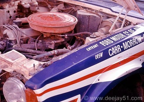

On the other hand, Ford Australia used to race I6's with the 2-bbl carb mounted far out on the side, with its float bowel mounted forward. No issues despite technically poor fuel distribution figures, typical of any I6 installation that has the Holley 2-bbl accessing fuel non uniformly from one side. V8's don't have issues when mounted with the float bowl forward, but I6's do. Its technically wrong, but Ford Australia with all its 2v 250's and Chrylser Australia with all its 2-bbl and 4-bbl 245 and 265's mounted the csrb the wrong way, yet it worked perfectly.

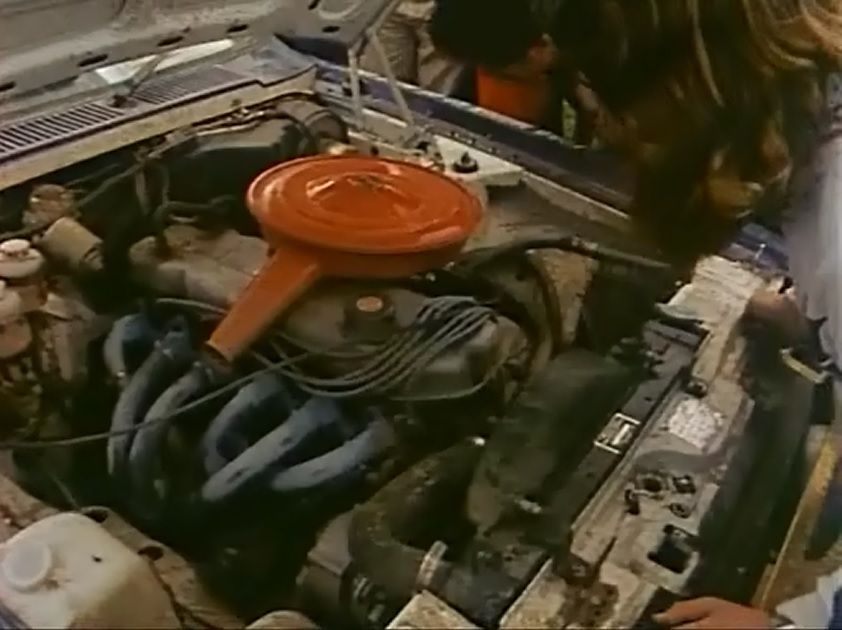

so the float bowel faces the front. It often is on the overseas Aussie 2V 250 and Argentina ME 188 conversions. But then the standard 2300 series linkage is hard up against the rocker cover. Some guys turn the carb backwards towards the firewall like the early tripower Holley 352/390, 406, 427 and 289 engines.Unlike the Weber DG series and Holley Weber 5200/6500 series, the Holley 2300/4150/4160/4180 series is best mounted parallel to the crank on six cylinder engines, or the "rooster tail" of atomised fuel will be poorly distributed so the back cylinders get too much fuel and the fronts starve, as the air fuel mixture has weight and inertia as it tumbles down into the log head.
