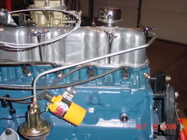

I spent the afternoon looking at fuel lines and decided to go with this size and went ahead and put it directly into the carb minus the barb. I know I should have a filter between the carb and the pump as well as one between the tank and the pump. Where should I put the one between the pump and the carb?
Also take a look at the headers and my line----it isn't really that close as to the headers as it looks it is above the log by a 2 to 3 inches, but does anyone think I need to wrap the line or do something here to keep it from heating up??
