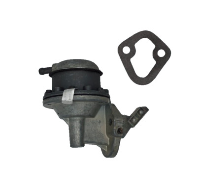

All Small Six This ebay fuel pump is rebuildable right?
From the description I would say it it. Unless it’s too big for mustang engine bay. It looks bulky 🤔
Ones without the glass sediment bowl or filter canister are a bit more compact.
I like that better. It is rebuildable also?
Does that one have vacuum?, you are still looking for one that does right?

NOS would be the best for sure and will keep looking on ebay and others. So now looking for two rebuildable pumps, one for a 200 and one for a 250. No vacuum needed.
I noticed in the application chart it is for 144/170. I doubt if a 200 would be a different pump unless it has higher volume which seems unlikely. Will try to contact the seller just to be sure.
