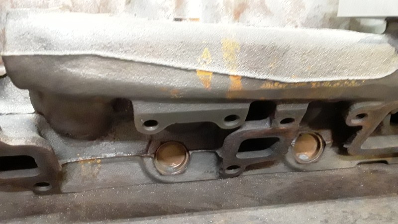

It's a manual, 3-Spd on the floor. I did not find the thread you linked to when I was researching this so I need to read that a bit more. The linkage/bracket they show looks like the one I'm getting from Econoline. I dont have the rear holes for mounting that the 250 has but I'm hoping I can figure something out. Here is a pick of what I have now with the arm sitting on the header.
"...I dont have the rear holes..."
the header bolts R it, double duty...
I think you'll C when U get it.
Let us know.
(BTW:The pic really wrks)
