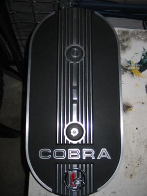

I'm using this:
I'm using it. It is really low profile. it is shorter then my stock cleaner. It is only about 1.5" high. I'm going to make my own base and cut it for the 3-1V intakes. I have two bases for 1-4V and 2-4V. I may just reuse the 1-4V and cut out the outer holes. The other thing is that I can always recess them. The Autolites are actually not that tall...I'm not using the Holley Autolites. The holley autolites are very tall.
Slade[/img]
Slade, I like the looks of that. Where did you get it, what part number, etc.
Bill
