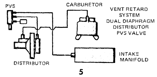

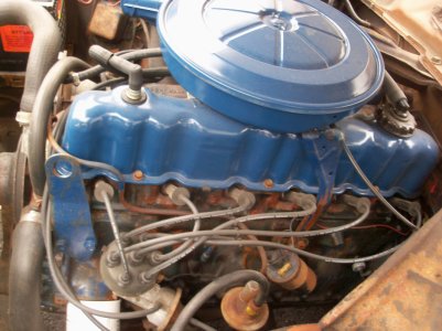

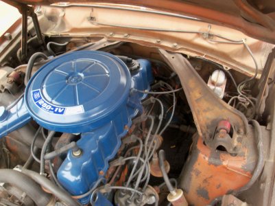

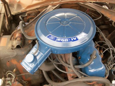

'my 74 - 3 OTT - from N.E., had only an EGR valved to exhaust manifold , Dual Vac line distributor PVS , Hot air duct Aircleaner, Charcoal canister vent to aircleaner.
typical dual vac dizzy:
