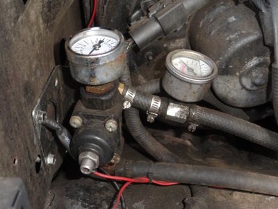

Necessary in this case- 70psi EFI pump into a primary regulator with return line, gets it to about 12psi. The first gauge monitors the first regulator.One one high pressure side and one on low pressure side…. Good idea and good info from two guages.![]()
