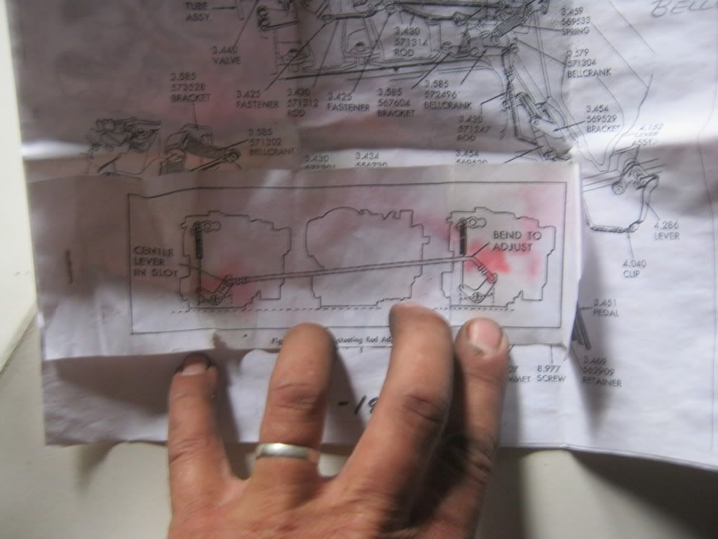

Since you've asked for How to vac secondary carb your tri power, you've got the best info from us all. Go have some fun.
