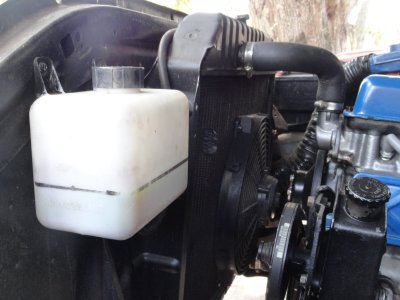

Running a spring reinforced lower hose is also a good idea. Overflow jug is needed, blown coolant gets sucked back as when the system cools off.

Overflow tanks are 10 bucks on Amazon, easy install and totally worth it. The radiator can be kept full and no expensive coolant is lost when it heats up.

All is good. Have taken a few drives in this heat and it’s running good and not getting overheated. Just need some wheels and tires and lower the front end a bit to get it from takeoff to flying level and it can be my daily driver for a while.
