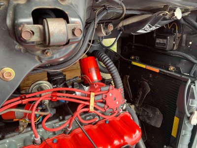

A little update. I found a guy on Craigslist with a 4 barrel 289 air cleaner near me.
I’m going to make a fibreglass insert to fit the webber carb to the air cleaner housing, tne same size as the 4 barrel outer diameter and I’ll set it up to a height that fits under the hood. I'll continue to use the weber oiled filter and have it inside the ford air cleaner and plumb cold air to it through the radiator support.
I’ll have to get a 200 Sprint decal for it, not that anyone would be fooled into believing it was a 289 :LOL:

View attachment 27848View attachment 27849
