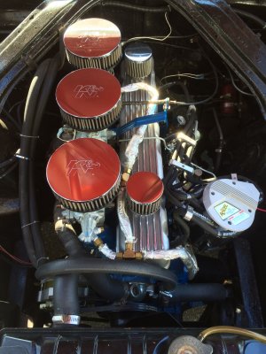

Tricarbs are sweet. Makes for eye candy at the car shows. I entered 3 judging shows and came home with 3 trophies. I think it was the tripower set up that did it. The joys of multiple carbs are that you have endless time making adjustments. I use Webers ICT/ICH combo. The beauty of Webers are that there’s a lot of adjustments. The downside is that there’s a lot of adjustments. A wideband 02 made tuning much more accurate.
Oh no… it’s happening. Scope creep. I’m starting to seriously consider multiple carbs. Maybe I ought to have the log machined for 3 openings and bolt covers on the outside ones so I can go with the Weber to begin with and then expand to multiple carbs later. I really want to have the head done for next spring.
In terms of running multiple carbs, I figure/hope it’s dialing them in that’s the work. If the linkage is good, they should remain in tune. My hot rod BMW had twin Mikuni 44mm side drafts. I put them on, dialed them in and drove the car for many years without needing to do anything aside from plugs, points and oil changes. My motorbikes are all multi-carb’d as well and I’ve never had carb balancing issues. I would think cab balancing would be less of a critical issue on a log than if each carb was a closed circuit on each cylinder too.

The carbs are not necessarily going to tune the same. (Idle mixture). Using a digital tach on a timing light and careful tweaking of each will get the job done. On this Aussispeed intake the two mixture screws on a single 2 barrel aren't the same. Outboard barrel is slightly richer. . . Anyway tri-power is cool regardless. vssman's pic above makes me want to run out and start drilling holes in my intake! :D

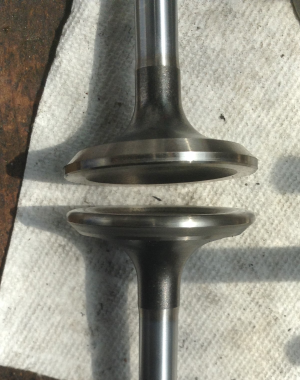

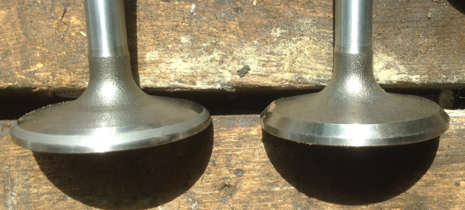

That guy (Eric Weingartner) says you can’t back cut your valves at home. My drill press and bastard file say I can and I’d really love to give it a shot but maybe I should just ask the shop to back cut the valves at 30 degrees from the seat surface.
Did mine for a 300 on the drill press. Lapped the seats after(gray line). Has always been part of a build for me.
No need to backcut the exhaust(one way flow)
Just radius the margin on the exhaust
Keep the intake margin sharp.
