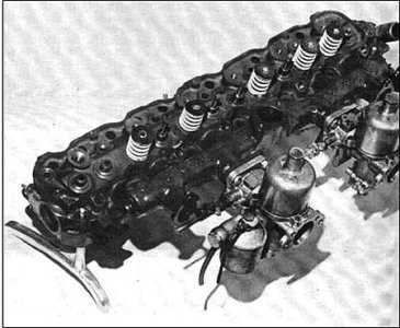

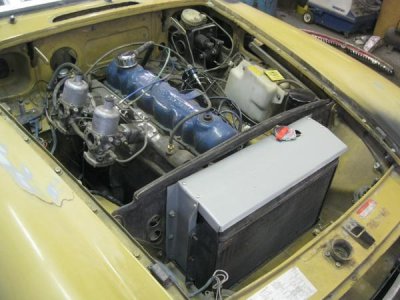

Missed the multi-carb discussion last month. Some pixxors, food for thought.
SU Carb assemblies and constituent parts are currently produced new by Burlen in the UK. If you want new carbs, bend over, they're pretty pricy, but but less eye-watering pieces can be obtained by purchasing used carbs. I have an MGC (six cylinder MG) that came stock with qty=2 HS-6 SU's (1.75 throttle bore size) and have a triple intake manifold. Scour e-bay for MG, Triumph, and Volvo for the carbs and have them sent in to a reliable rebuilder. There are a couple of quality rebuilders in the US (Joe Curto on the east coast, Jimmy Hilton in TX are my favs) The can be set up from straight horizontal to about 45 degree downdraft. I've seen one example of a true down draft.
Do not confuse SU's with Zenith Strombergs- SU's are a less complex carb and more highly tunable
Edit- the B&W picture is using a more primitive variant an HD-6- The 200 in an MG is using a latter variant- HIF-4 (1.5" throttle bore
I should point out these are constant depression carbs- the have both a throttle plate and a vacuum controlled piston.
