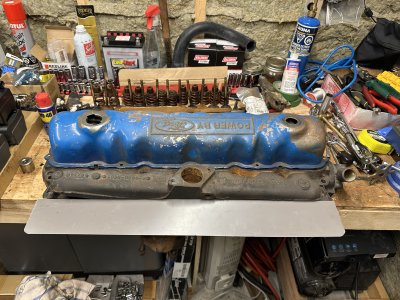

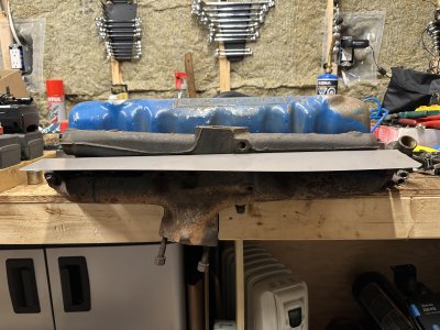

Aluminum is a good conductor and will also conduct heat to the other side, steel would better, and better if mirror finish on the side to reflect heat away. A barrier of anything would be better than none.
I agree with what Frank said.
