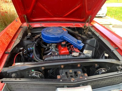

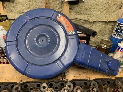

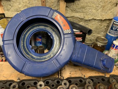

A little update. I found a guy on Craigslist with a 4 barrel 289 air cleaner near me.

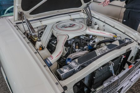

I’m going to make a fibreglass insert to fit the webber carb to the air cleaner housing, tne same size as the 4 barrel outer diameter and I’ll set it up to a height that fits under the hood. I'll continue to use the weber oiled filter and have it inside the ford air cleaner and plumb cold air to it through the radiator support.

I like that 289 air cleaner. A couple years ago I looked into having a v8 air cleaner on my 250 but seem to recall it interfered with the oil filler cap but I was test fitting with a 351 air cleaner I had. So the 289 is the one apparently. I got started on that because the 144, 170, 200 and 250 all used the same size air filter and the 250 is much closer in cubes to the 289 than it is to the 144. I don't have factual evidence the 250 needs a bigger air cleaner but more is often better.

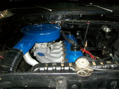

I personally really like this. I'm the loudest advocate of factory intake filter housings on here, for better or worse. Not just the cool air, worth 1% power increase per a mere 5*F , but also for the hot air system. The hot air part of the system is even more critical/beneficial in my climate for preventing carb icing, which can begin as high as 68*F. Winter ambient low temp 35-55* with near 100% humidity, without the hot air snorkel, I'm stalling, engine flooded at every stop, the first 10 minutes cold.
Aside from the mechanical benefits, these filters are rugged, and quiet. in my youth I liked hearing the intake "roar", the factory system keeps all that suction racket contained.
Switching to the a'market intake and 2V carb from the factory 1V I had to find a factory housing. This one's from a '77 Jeep. "It works."

Not so sure that I would do that on a car that might get driven in the rain or a dusty road. That area gets everything flung off the tires. A inner fender may have been added. Sure looks nice.
Interesting!! The snorkels look like they are sealed inside to something, not the outer filter housing🤔
So, its crap weather around here now so I'll have to work on the large log head and other things until it's car season again but I did test fit the air cleaner housing on my Weber carb and it'll work. The hood will just not close with the carb on the small log because the adapter puts the carb too high but with the large log, I'm going to machine the log and mount the carb to a plate that I'll mount onto the large log so it'll be a few inches lower and that'll give me plenty of room. Plenty of room for access to the oil cap too.

I should be able to easily pull cold air through the radiator support where the voltage regulator is currently and route it right into the air cleaner.
They may not be attached at all- engine shift and vibrations bolted directly to the body, not good. I see the rubber connector at the fender, that's probably not enough give for the system. On hard acceleration the filter housing is moving 1/2" or more right, unless they've solid m. mounts. I wouldn't want all that pressure on the single 1/4" stud in the carb, looks like they don't either.
I understand the movement of the engine. I would think absorbing the movement with flex in the ductwork would be better than sucking g in hot engine bay air, kinda defeats the goal🤔
Good point. Weighing the odds- a small % of underhood air better than 100%. Ripping the carb stud from the center of the carb would present major issues. When in motion, the ducted air has higher pressure than underhood, and would displace any intrusion.

Much appreciated. That snorkel kit looks really reasonably priced. I’ve got that 289 air filter housing off a Falcon that I will probably use but if it turns out to be too finicky to fit, I’ll jump on that snorkel kit.
