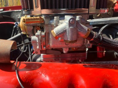

My experience - I added a wood spacer below my stock autolite 1100 carb and added a heat shield made from a license plate that fits around the water cooled spacer and shields the carb and fuel line from the radiant heat off the exhaust manifold. The results have been great. I've commuted on some 95+ degree days with no issues, even when sitting in traffic.
