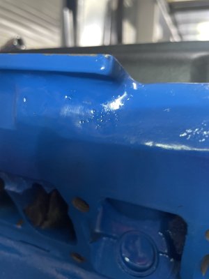

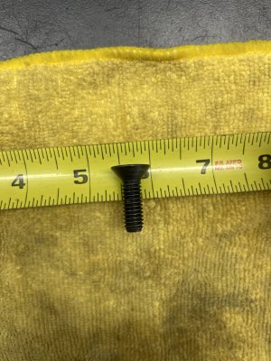

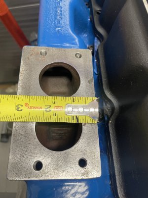

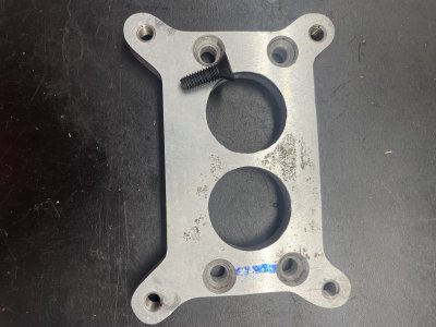

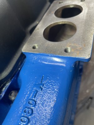

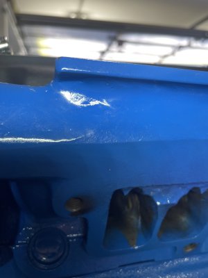

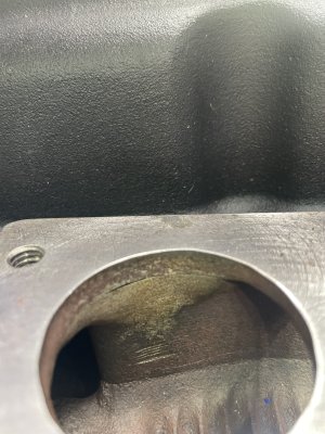

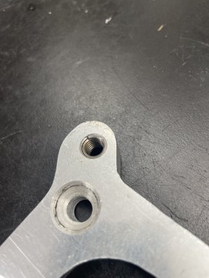

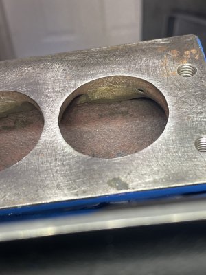

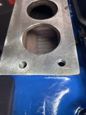

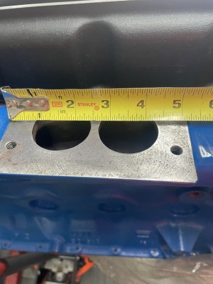

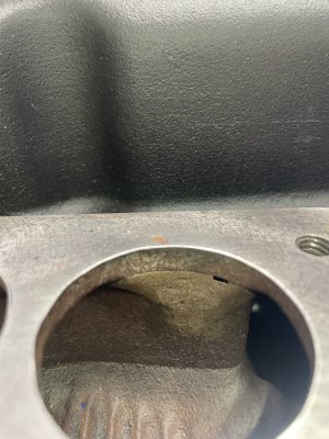

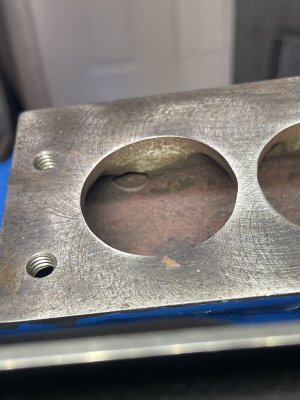

Just some photos of the mod. The four holes he made are not semetrical, you can’t flip the adapter end for end- the holes won’t line up. Not a big deal but a pain when making adapter and bothers my brain!!🥸🥸.
Other than that, I think he did a good job. Bolt /screw sizes are all 5/16 x 18. He made the throttle bore holes 1.635 on the inlet side and 1.70 on the outlet side.
Let me know if you have any other questions 👍
The adapter:
And the intake mod:
That's a nice intake Don! Did you do that work? (Need to send you a big6 log intake for the same treatment!)
Yep, that is a super nice job on the intake log modification @DON. That is exactly how I'll be doing mine (y)
I've seen a lot of mods and adapters where the adapter takes a separate barrel carb base and dump it into an oval. Is there a benefit to maintaining the separate barrels as long as possible like yours or is it fine to just dump it into the log via an oval? I'm looking to get the best bang for the buck.

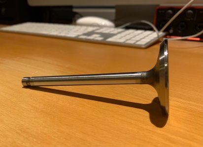

Well 4 of the 6 intake valves I ordered from Rock Auto are the 1.75" intakes for a Ford inline 6 and 2 were for a Saturn SC Coupe 1991-98 :banghead:
They're totally useless to me and I just checked the price, they're valued at double the price of the valves I ordered.
I just put in another order for the valves and shipping is 4x the price of the valves. I ordered them originally with some other things so as to offset the shipping costs... Argh... :oops:
Anyway, I compared them briefly with the smaller intakes that the head came with and there is noticeably more meat on the back of the valve than the OEM valves have so I'm glad that it's been suggested to back cut them.
