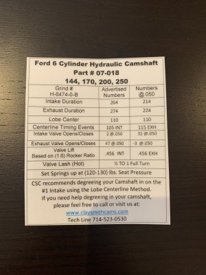

I was thinking the same thing. I’ve got the H-6474-0-B camshaft from Clay Smith. I don’t know how much quicker it bleeds off compression compared to stock duration camshaft but I suspect it does some.
I would run the numbers with your cam on a dynamic compression tool and see where you are at. 94 octane will give you a buffer

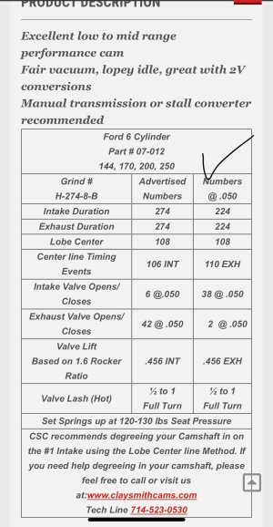

Back in the day when everyone would come to my garage to smoke and have beers while I was assembling some kind of frankenstein engine, compression numbers were confidently thrown around as though we knew what we were talking about (we didn't) :ROFLMAO: Yep, next build I'll get those TRW 12.5:1 compression pistons and this beast is going to rock :ROFLMAO:
So, I ran some actual numbers with real specs and it looks as though I currently have 7.87:1 Dynamic Compression and dynamic cranking pressure is 159.81 PSI. I have not checked what my actual cranking pressure is but it seems reasonable.
I have read a few opinions about dynamic compression and the common consensus says that for pump gas, the most you want is 8.5:1.
If I bump up my static compression to 9:1 static compression, my dynamic compression will be just over 8.5:1.
That is, if I am reading my cam card correctly. The card says intake opens/closes at 32° ABDC @.050 which is what I used. I used the tool here: http://www.wallaceracing.com/dynamic-cr.php
This is my card:
I’m at around 10:1 static and hoping to use 91 octane. I have been told I’ll be ok and that it will be interesting to see.

I don't know the duration of the stock cam on the small6. If it were a big6, both cams above INCREASE dynamic compression. Almost all the aftermarket cams do, they have less gross duration than the stock cam. They also increase dynamic by increased effective .050" duration cylinder filling.
When crunching camshaft stats, keep in mind that all measurements are in crankshaft degrees, except the LSA (Lobe Center) which is in camshaft degrees. Thus Don's cam @ 108* LSA has FOUR degrees less gross duration for the same duration # than a cam @ 110* LSA. Don's cam, even at 274* would still increase compression over a stock cam (remember, example is on a 300)
Stock (big6) cam: 268* intake duration @ 110* LSA. , retarded 4* This cam closes the intake valve 68* after bottom dead center.
Your Clay Smith cam: 264* intake duration @ 110* LSA, advanced 4*. this cam closes the intake valve 58* after BDC. That's 10* more piston upstroke with the valve closed on compression stroke- more dynamic compression.
On a big6 with EFI head, using awasson's cam above, the stock cam has 6.8:1 dynamic compression, the Clay Smith has 7.3:1. The Clay Smith would require 93 octane gas in a 300, the stock cam 87 octane.
To calculate intake valve closing point: (gross duration divided by 2) + LSA - 180.
If all the boxes are filled in correctly, this is the compression calculator to use. Don't guess, small changes in deck clearance, gasket thickness and head volume make a notable difference in CR. If I'm searching for maximum compression for a given fuel grade, I find the target intake valve closing point, then calculate "backwards" to the cam duration that meets that parameter. This is why the Crower cam on my 240 build is retarded 1* rather than advanced. Flat top pistons, and 26 thou shaved off the block. I am able to use regular gas- barely. If the cam was advanced, no way. It has 9.65:1 static compression and 7.4:1 dynamic. According to this forum, the small6 can withstand higher compression numbers on a given fuel grade.

Thanks @Frank You have recommended that calculator to me before for calculating my CR. I just didn't realize it did Dynamic too. I reran the numbers.
Regarding Intake Closing Point (degrees) ABDC. I installed my cam straight up to the cam card within about 3/4° so if I use the calculation of (gross duration divided by 2) + LSA - 180, I get: 264 / 2 + 110 - 180 = 62°
The calculator page suggests Intake Closing Point (degrees) ABDC @ 0.050 lift plus 15 degrees which would be 32 + 15 = 47°
Running those numbers with Intake Closing Point (degrees) ABDC at 62° I am at:
