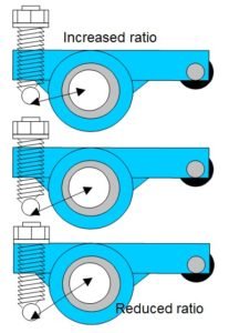

One thing I would recommend if you get some adjustable rocker arms: install the longest pushrods you can fit. That gives you the maximum lift possible. Here is a link that explains that a little more in depth: https://www.eatonbalancing.com/2007...-ratio-by-varying-the-length-of-the-pushrods/
I prefer 3/8'' pushrods, more stable and weigh about the same as the stock solid rod skinny one if you go with a thinner wall. They say that when it comes to pushrods that stiff is more important than weight, but we do not need a thousand pound spring to control our valves. With stock rocker and iron head I have not seen a fitting issue, but always check. Higher ratio rockers may need minor clearancing of the pushrod hole because the rocker moves the pushrod toward the rocker to get the increased ratio. only remove what is needed, this is one place that does not need much clearance.
I do not recommend 3/8'' pushrods for the Aluminum head as there has been fitment issues at push rod hole.
If I remember correctly, it was posted that rocker arm to valve/ valve spring was about 0.050.
