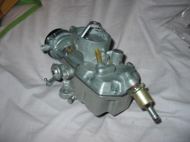

I'm 99% sure you need an Autolite 1100 for the concours correct carb for the 65 mustang 200.
should look like this:
Personally, I like the 1100 for a stock engine. IT is a pretty easy carb to work with. Nice upgrades are the clifford 2-1 adaptor and go with a holley. Also, if you stay with a 1V, I hear a Carter RBS (is that right?) is a nice upgrade, but might not fit your head if you have a stock 65 head.

Cobrasix...great thats exactly what it looked like. Mine was jacked out of my truck...doubt they even knew what it was.
