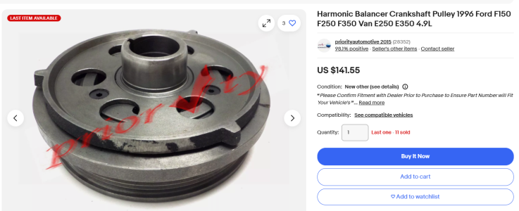

No, it's been done. I can't remember the thread. There's a damper- think it's the '96 model- that accepts a trigger wheel. Someone made a custom top for their distributor to reference, flat, only sticks out of the block a few inches. Others will have to take it from here, but no you're not out in the weeds.
