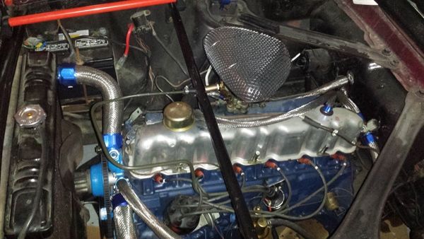

I have the tri-corner air-cleaner with a similar setup ('67 Mustang, Holley 1940 carb, vaccume adaptor plate). however, I had to trim about 3/8" or so of material off the mounting flange of the aircleaner in order to clear the hood. This also meant I had to purchase the adapter plate for the carb. My issue is that I have a straight Monte Carlo bar installed so I could not use the original filter.
