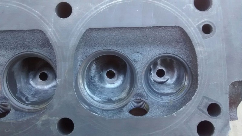

My '63 wagon 170/5200/T5 gets @ 25 MPG but the worked D7 head running close to 10:1 SCR (48cc CC's and metal shim gasket) uses 93 octane minimum... , the '61 runs race gas at the track with 274 cam / 500cfm+ 2Bbl / blueprinted HiPo 250 (bored to 258) ,will shift @ 5000 RPM.
v . Image . Image
.. machinist asked NOT to cut D6 250 head with OEM 62cc chambers at all for needed low compression project:

powerband wrote:The FalconSixPerformance manual helps think through a reasonable build schedule. Head and other work can start with measuring current 'CC.s of compression chambers of head used. Confidence in projected CR - static and dynamic depend on reasonable figures for the cam selection and machine work. Drivability upgrades for modern times, , cruise and show or real hot rod six money, planning the basic engine work can optimize your goal.
I got a quote from a shop here in town for all the machine work. They came back with something like $600 to hot tank, magnaflux, install new guides, complete valve job and cut for oversize valves, mill off 1 bbl boss, and 0.070" milled.
sounds like a plan' , the .070 cut will raise the compression ratio to figure.
v . Image . Image
That looks like a 170 head. What size are the chambers now??

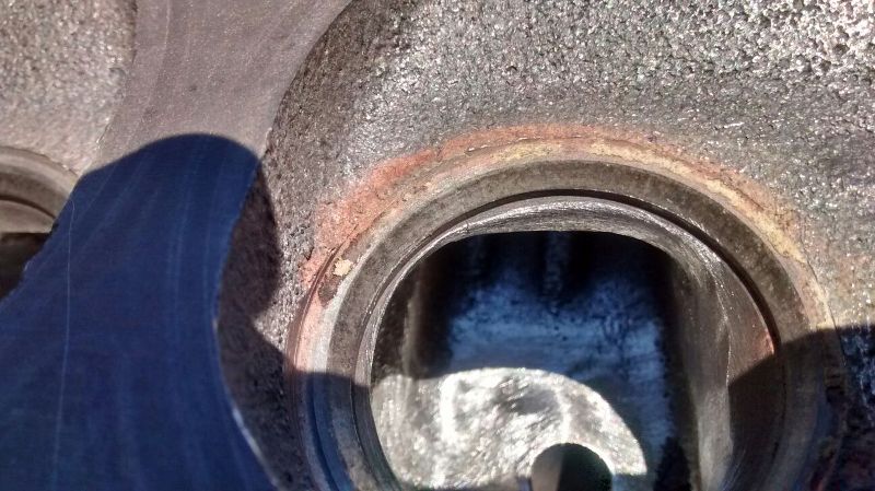

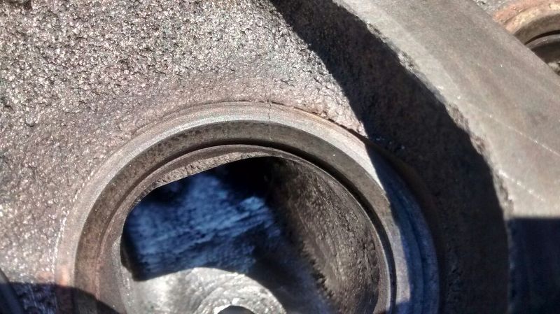

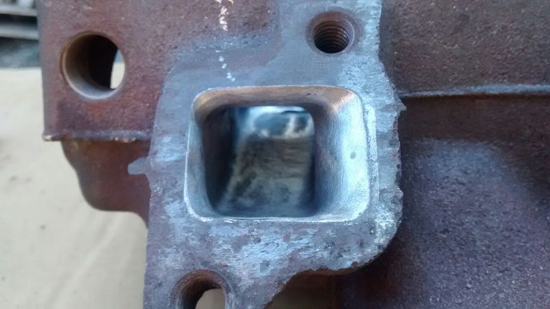

OP, outside of some radical log cutting project you're left with larger valves, 1.44-1.5/1.75, basic porting, 2 barrel mod... I'm also going thru this currently. Had a D7 head that I had dipped and it turned out to have a couple cracks at the siamese exhaust valve ports so I'm back on my C9 head. The C9 casting looks much better anyway. My advise to you is to look at the cam you have, if you're keeping it and go from there. Carefully measure and then calculate your DCR based on your cam. Then you will know how much to mill the head and exactly where you are when you bolt it back together. I'm going with 144 intakes for exhausts, no hardened seats and some porting. Erson 280 cam, 1000-4500 short gears and overdrive, 7.5-7.7 dcr and 9.5-9.7 SCR depending on how much chamber I lose in the clean up and what gasket I use.
Some picks of the cracked head :evil: Had 4 hrs in it when I noticed the cracks. Machinist hadn't gotten to magnafluxing and I took it anyway in a rush....

for Econoline et al '
That looks like a 170 head. What size are the chambers now??.
Keen observation! , the filled valve area give it away?. I think the uncut DODE (Maverick170) head measured 58cc' chambers. Image.Image
.. the pics' is from confirming combustion chambers volumes' for suitable head for low CR (@ 8:1 SCR) 250 project. Found D6DE uncut 250 head measured @ 62cc chambers.

:hmmm: Econoline from your pictures it looks like it would only take a couple of exhaust seats and maybe some pinning to repair that head for use again! :hmmm: The original head on my 250 very low mileage 77 Maverick (is also a D7) but its in much worse condition. :nod:

Post #19 by Econoline » Wed Sep 16, 2015 3:27 pm
It's hard to see in those two pictures, but the cracks extend above and below the seats into the cast. Probably could be fixed like you say but I'd rather just put my energy and $ into a better head. The casting quality on that D7 is really poor. My plan is to use the original C9 head( which has cleaned up real nice in the tank, just got it back), do some mild porting, use the intake valves from the D7 and some NOS 144 intakes for exhaust, install the original rbs carb and get her running. Then look for another head to work on for all the better mods, Si valves, 2 barrel ect.

Jackfish that's some nice exhaust port work.
Econoline your work in the bowl area is real nice.
