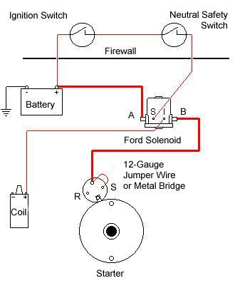

Hi, your first test is take the little wire off the solenoid (next to the big one from the battery) and hook up a test light to the negative battery post. When your helper turns the key to start the light should go on, key to run the light should go off. Do this a few times. Is it possible the solenoid is upside down? The bracket should be up top. Good luck

On a Ford Solenoid, how exactly are you jumping it with a screwdriver?
Which terminals are you connecting?
Hi, to crank the engine with a screw driver or a starter switch the small wire near the battery wire is removed and that terminal marked S is jumped to the battery terminal marked A. Be aware that if the key is on the engine may start, and if in gear it will roll. As mentioned before test at small wire from S for current when key is held on start. When key is held on start, or S to A is jumped, the heavy wire to the starter B should be hot. Terminal I (which is not on ALL cars) gives the distributor all 12 volts to aid in starting and like B is only hot when the key is held to start. The solenoid delivers battery voltage to the starter when 12 volts is applied to S. Good luck
After sleeping on it, and reading back through the OP, I'm thinking that the problem is in your ignition switch, and I suspect poor / corroded connections on the back of it.
My theory is that the switch isn't sending enough current to trigger the solenoid, but enough to hold it in once you jump it directly with a screwdriver (assuming you're jumping the battery and 'S' terminals).
Put a voltmeter on the 'S' terminal wire, you should see the same as battery voltage. I'm guessing it'll be lower, in which case you should take a close look at the connector on the back of the switch.
