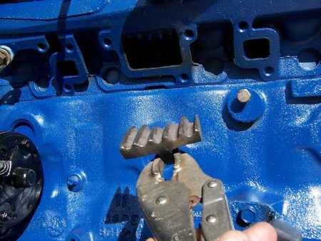

Informed by machine shop the 200 head is cracked in the usual place (between 3/4 exhaust ports I think) so not quite so eager to go cutting on my 170 head any more...but I'm still gonna do it!
chad
Posts: 4984
Re: Offenhauser 3x1 Build Thread
Post #17 by chad » Fri Jan 27, 2017 5:43 pm
Some expierenced w/'forge welding' have done a more than adiquite job of saving.
The better jobs on the 200/250 have chosen specific heads and added materiel B4

Meanwhile, my 'wedge' I calls it, arrived today. If nothing else, I hope it resolves my exhaust gasket issues. They seem to blow out at 3-4 ports regardless if manifold or headers are installed. I'll also obtain a higher quality gasket to go with the wedge.
Thanks,
Jeff

Post #26 by chad » Thu Mar 02, 2017 7:08 am
yup, dat's it. The thin edge goes in 1st...
