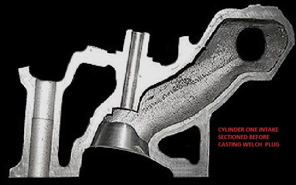

The early log is sure small inside, all early ones the same, 170, 200.
The reason for the 1.06 or 1.09" holes for the outer two carbs is that inside the head, it is 1.125" maximum. The casting is thick, and its small in their.

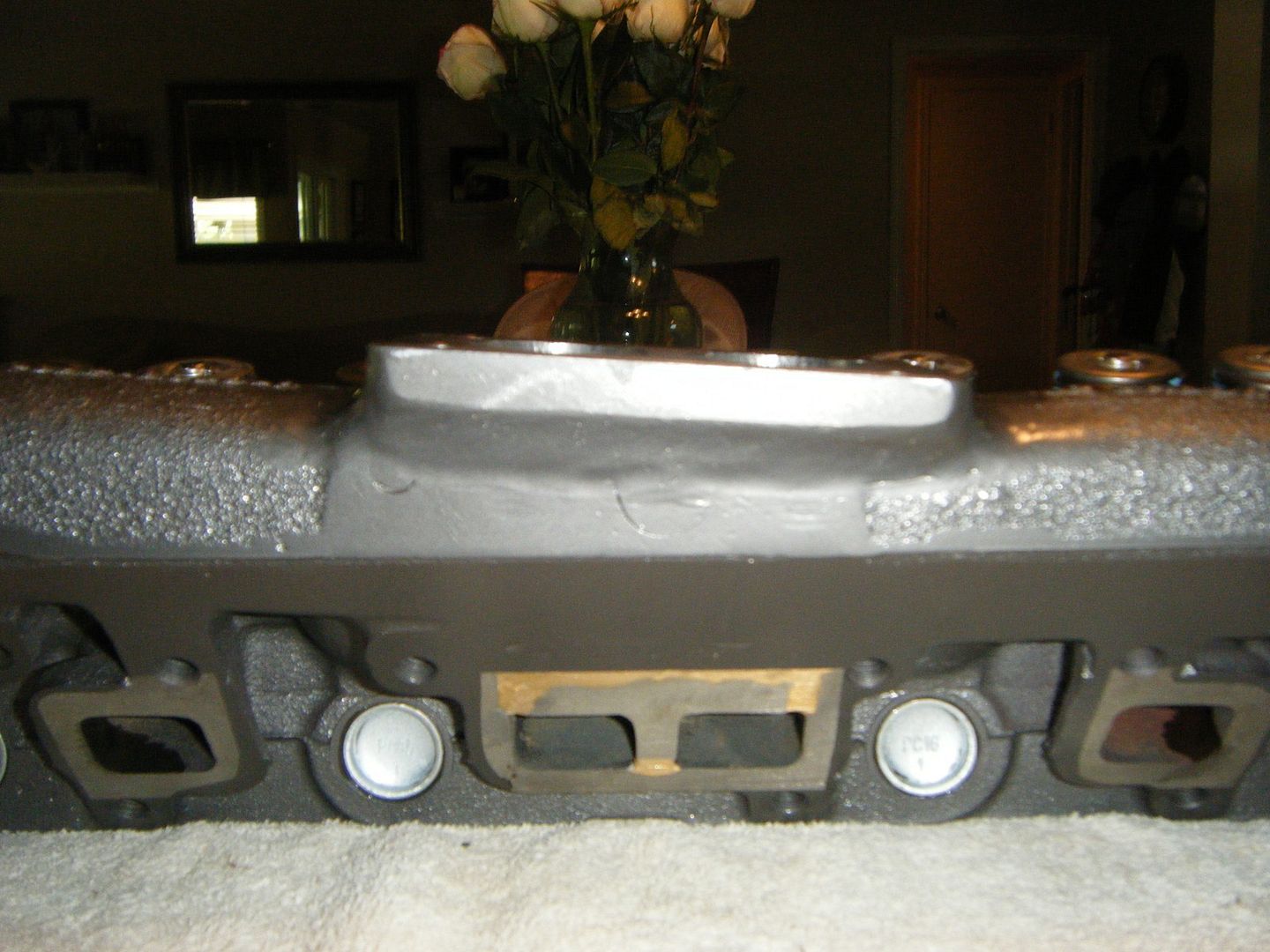

Hey do you guys know what epoxy folks use for these port dividers?

Post #64 by chad » Wed Jul 05, 2017 10:54 pm
" what epoxy…"
[quote=hahahaha... that is funny![/quote]
no seriously, they R usually tack welded / brazed after (4 me alota) hand filing / bench grinding to fit.
3 lill tacks in each corner of the "T" shape the 'wedge' forms.
I used a burr on a pneumatic 'dremel'.
I guess some sorta hi temp 'glue' would wrk, not a experimenter so used hi nickel rod in a stick welder.

Post #65 by Gene Fiore » Thu Jul 06, 2017 5:23 pm
I've used this to attach my port divider. It's not a daily driver but has been installed for years and has not broken free.
http://www.cotronics.com/vo/cotr/rm_adhesive.htm

Thanks Gene, I will definitely look into that adhesive.

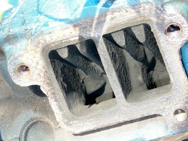

So I started drilling into the log for the rear carb, and I guess I never noticed before but all the intake ports flow downward to the valves. Like #1 intake is about 30 degrees and #6 is I'm guessing nearly 60 degrees downward. I guess I always assumed these ports were more parallel? Anyway I think this is a job that should be done with the head removed, so it's on hold again!
Jeff

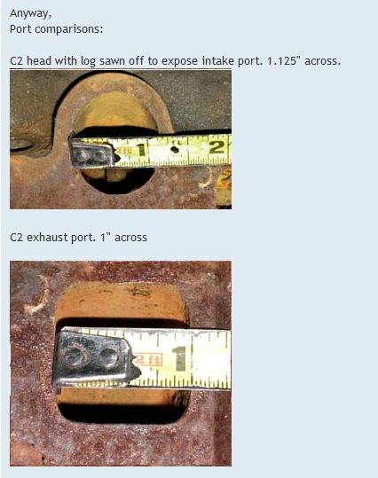

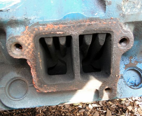

Jeff

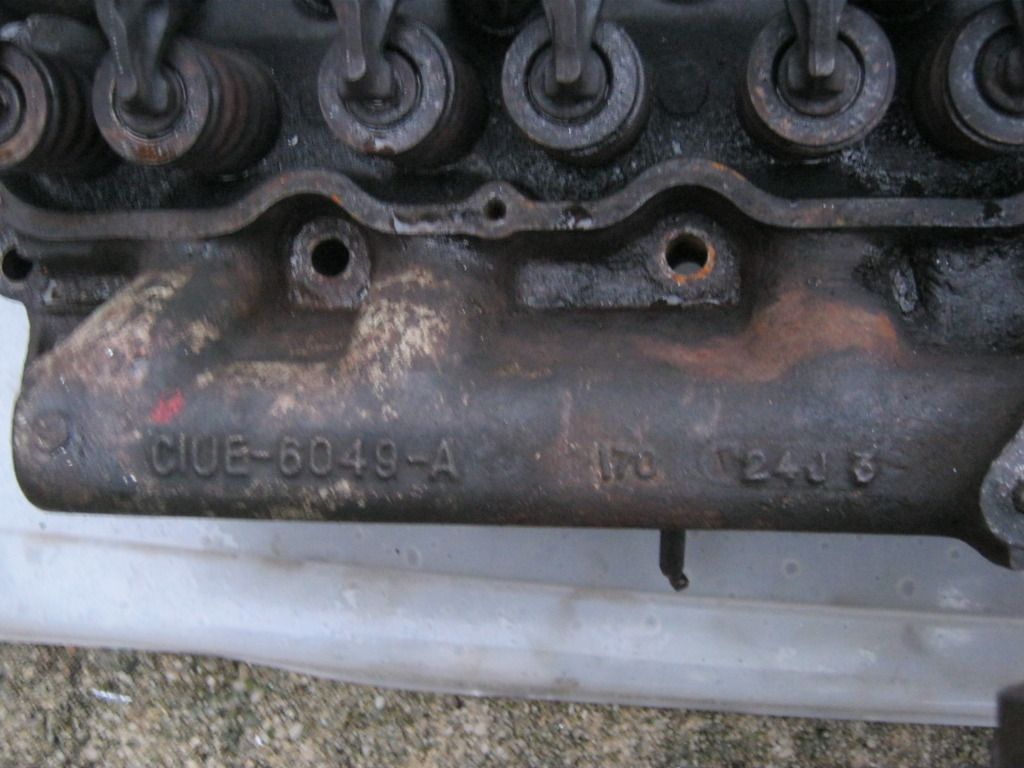

Untill you've spent real time "caresing the curves" of the log head, you just won't see how contorted the intake runners are. They were designed in late 1958, the casting locked in, even with alterations, for another 1/4 or a century till that last one was made for the 1983 Fairmont, Zephyr, and downsized LTD/Marquis.
Funny thing, even though thats the case, the Offy really makes any stock log head honk. Two extra carbs remove 16" of contorted 80 bends, and power goes up not by air increased air flow, but by having the gasoline right to the door of six cylinders at wide open throttle.
The port shape at the ends to cylinder one is odd, at cylinder 6, the upturn , well, its like sending a rat down a drainpipe
Guys have been cutting off the log head for years, and finding that the early 1961-1962 170/200 heads had only 1.125 " diameter ports with 1 sq inch of port serving a 2.13 sq in 1.65" diameter valve head, or a port 47% of the valve area.
The later log heads, port size and area went up in two big buzz cuts, 1969, and then again to even more port area intakes in 1976, and those D6 onwards valve heads were now typically quite big inside.

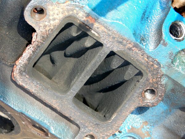

Here is what a normal late model log head looks like inside.
a host of Americans, like Fast64Ranchero, JTTurbo, Big Al the Hackmiester, who's tool of choice was the Sawzall, have taken these pictures.
Big log was a D8
Small log like the early ones
Experi Mental Frontal Log-otmy

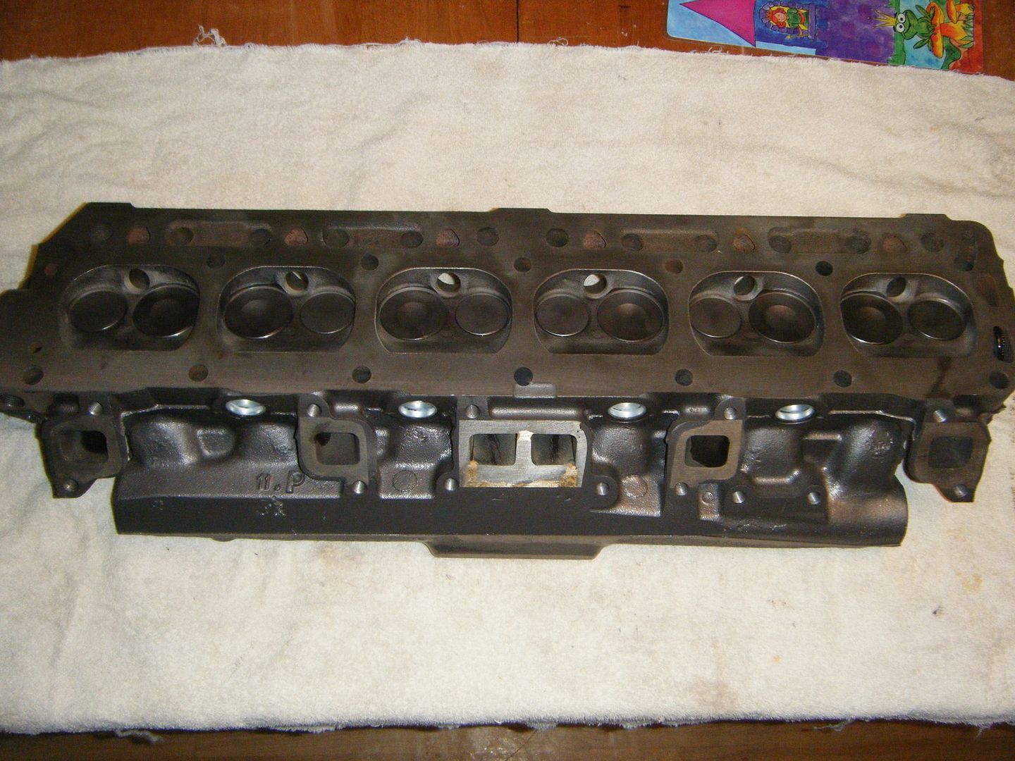

You can cut a 1/2" metal plate and have it welded in like this
Some C7 heads
came out factory like this....
Others have 'other' ideas

Got the log ready for the Offy adapter, my mig welder had no gas and couldnt get my arc welder to join the two so I found this stuff we'll see how it works
1strodeo
Posts: 99
Joined: Mon Oct 17, 2016 11:09 am
Re: Offenhauser 3x1 Build Thread
Post #85 by 1strodeo » Sat Jul 08, 2017 11:03 pm
Reached a stopping point, just wanted to update post, got port divider installed and adapter mounted, head installed obviously, found some fat o-rings for adapter but still may need to apply some rtv to seal completely.
Posts: 9303
Post #86 by bubba22349 » Sun Jul 09, 2017 8:55 am
:hmmm: you shouldn't need any sealer on the rubber O rings in any case don't use RTV the fuel will attack it. If you have to use a sealer try some of the non hardening Permatex. Good luck :nod:

Did some more metal work to avoid gooping up the o rings, ran outta time so capped off the outer carb holes with license plate metal and diy gasket material. Taking chassis back to my guy tomorrow because 1) anticipating the tub back from blaster any day and 2) I'm leaving town Saturday morning for a week of R&R on the Florida panhandle.

So i got a 66 head on my 65, how hard was it to cut the holes for the offy adapter? Did you drill or use a dremel, or something else?

To be honest I cannot remember exactly what I ended up using, probably the biggest drill bit I could find and a grinder bit to get the hole to size. Then I ground and filed the top of the log where needed until I could no longer see light between the log and adapter on the end holes. As you probably know this MUST be done with head removed due to the downward angle of the intake channels.

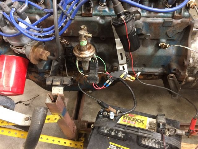

I'm hoping to get it running today, got a hillbilly setup for my radiator and battery, just need to wire up an ignition/starting circuit, wish me luck :wink:
Nice 'test stand' . An easy ignition setup for test or road' is an HEI module, the coil and module is all you need .
A Ford solenoid between Batt and atarter and any button switch for simple starting circuit.
haev fun

Hey thanks, I'm not sure what an HEI module is, I have a Duraspark setup from a '78 Granada?

1strodeo wrote:Hey thanks, I'm not sure what an HEI module is, I have a Duraspark setup from a '78 Granada?
It would replace the 'box', brain, module, alu finned metal 'box' in the DSII U have.
It can B seen in the middle pic.
Also called a 4 pin - U can C it nxt to the fuel pump w/4 ele lines to it.
(C "go fast for less dot something" for the whole scheme as it may take a 'thin foil' or other coil change too, may B not).
wsa111

This what you need. It does require a full 12V via a relay.
viewtopic.php?f=86&t=79447
You also need a coil with low primary resistance.
Also need your DS11 recurved for your application. Bill

here's a vendor and simple wiring diagram for the GM HEI ignition module as mentioned:
https://www.summitracing.com/parts/pro-66944c
(HEI module needs 12V supply, a full 12V coil (low resistance /TFI ) is best but any coil should/could work if properly powered for the coil type.)
Image . Image

Thanks all, so what is the advantage of switching my existing DSII to the HEI module, (maybe ?) new coil and recurved distributor? And what's the cost for distributor?

The advantage is a more reliable and much cheaper module that can fire a very low ohm coil without dying. Iow, much higher spark output. No points to replace and fiddle with to set dwell angle. It also has a variable dwell, keeping spark energy up as engine rpms increase by increasing dwell as rpms move up. The module has to be mounted to a heatsink. Another advantage is that you can run a TFI coil, that's what I did.

So if you now have a working DuraSpark II system then it's already a great system compared to the old points type. So in my opine there isn't much of a need to change it except maybe doing some custom curving of the advance. Good luck :thumbup: :nod:

smaller ie easier to carry a spare out on the trail (miles away), possibly easier to source than the DSII box, more durable (?), usually cheeper.
I've heard the TFI (coil) has draw backs, tho. Can use others. I'll go w/HEI 4pin myself when my current bx fails. rbhom uses the chrysler orange bx w/the DSII.
"...mounted to a heatsink." & the ele contact paste - if interested, again, I suggest a full read @ 'go fast"(the details :twisted:).
