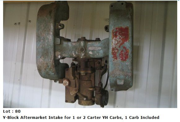

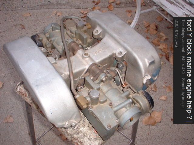

But now I hear there's a Carter YH side draft (an early '60s thru '66 I've heard) that's reliable (just so many sizes it's hard to assure/ID the right one) used on early vetts too.

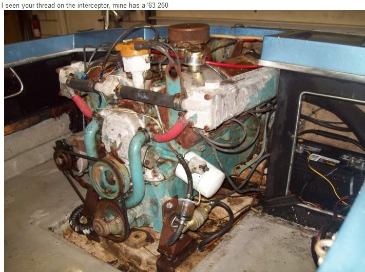

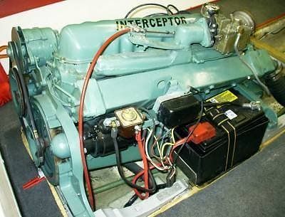

Matt Cox at Vintage Inlines sent me a picture a while back of some Falcon boat engines the had multiple sidedraft carbs.
Check with him. https://www.vintageinlines.com

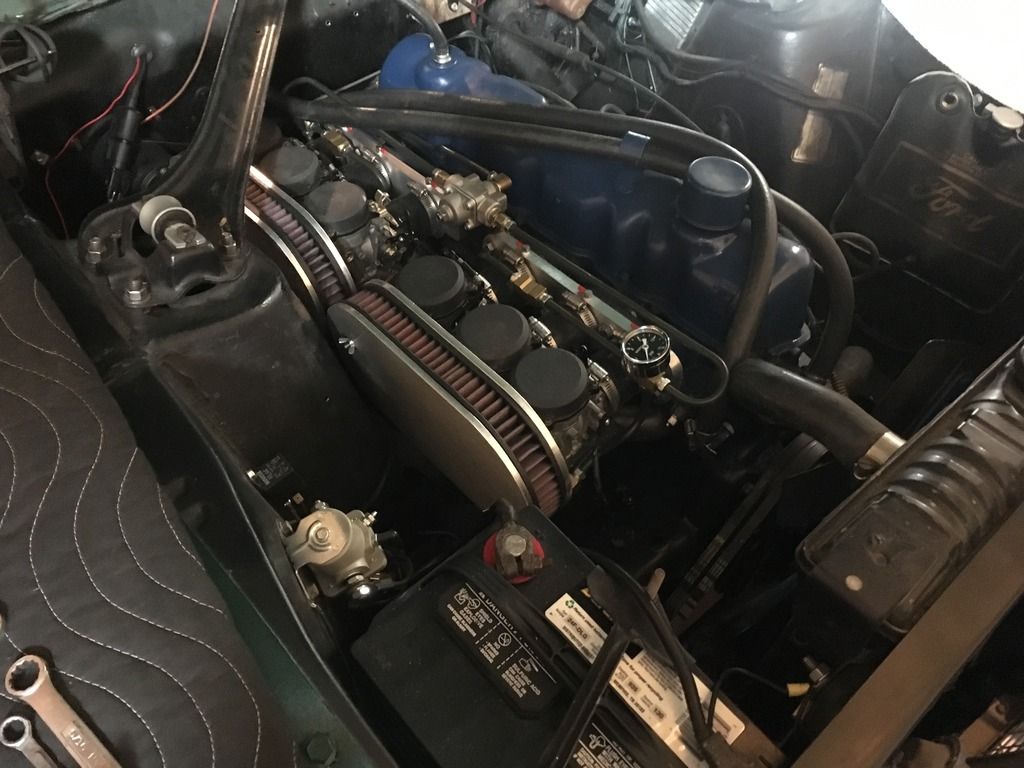

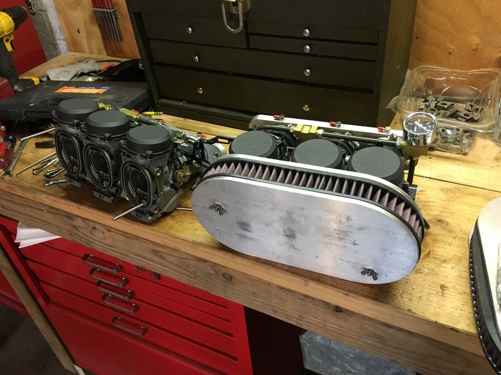

I'm still working on my set up. Have yet to post anything on my project and have been working on it on and off for about 3 years. Had it idle for the first time this weekend. Around 550rpm with a 260H cam.
I took 2 ZX9R carb banks and modified the linkage spacing to work with the port spacing on the 250-2V head. Clearance is extremely tight between the towers and the headers. I had to dimple the the six exhaust tube on my pacemaker headers for carb clearance and may need to move that header tube completely.
Hopefully this weekend will finished the throttle cable and pedal set up (using a 1970 mustang pedal). Tied both banks together using a cable splitter off a triumph motorcycle.

Post #12 by chad » Tue Feb 28, 2017 7:34 pm
"...tight between the towers and the headers…"
my goodness, yes! But U fit it in,no!?!
The 'plenum' between the carbs & head look no thicker than an inch or so. Just a thick plate.
U manufactured that plate urself, no?
It's not the "ZX9R" intake is it? Nother fella made a much wider intake between the carbs and head. Not sure how it would fit unless angled up like the Lynx or another (forget which one) Oz major automotive after market company's design.
And those R the Keihins you're using?

Yes it all fits! But one of the carb bowls is a little closer to the number one exhaust tube than I like.
I built the intake on my hobby cnc. 1/2 6061 plate with aluminum tubing brazed to fit the carbs to. Most swaps I have seen with the ZX9R racks preserve the spacing between the carbs and have the intake make up the difference between the port spacing. I did the opposite where I modified the carb spacing to match the port spacing. Was a little more time consuming as I had to modify the linkage between the carbs.
Yes the carbs are keihin cvk's. The constant depression style carbs similar to SU's.
I kept the intake straight off the head for mounting simplicity but I feel an angled intake would definitely be better for overall header and tower clearance.

thats a good looking set up -
any more photos of your manifold?
and this is an Australian 250 2V head ?

Yes, its a 250-2V. These carbs like very low pressure. I actually swapped the spring in my low pressure regulator to get it down to 1lb of pressure.
Here are some more pictures.

Post #17 by Econoline » Fri Mar 03, 2017 10:32 am
That is way cooler than any V8 build :D

Do you have any shots of how you modified the head and the intake throats w/out the carbs? That is the most amazing setup we have seen in a long while.

Real similar to the deal I have, except I used the rubber carb spigits screwed to a flat plate for the intake.
I'm tying to figure out how to best use the rubber velocity stacks inside an air cleaner.
What filters are you running?

Now I C U have ~ 3 inch tubes…
Thanks, the pic really helps!

I didn't need to modify the head for the swap. All I did was make the aluminum flanges line up with the ports on the 250-2v. Then I just modified the carb linkage to match.
I have not had a chance to fool with the jetting. I have to replace one of the fuel line lines before testing. I did wire in a wideband to aid in the process.
I also had to build the filters. I ended up using KN filter and found one on their website by searching the dimensions. The oval filters are originally for a Mini 1.3L.

Re: one carb per cyl - various falcon motors
Post #25 by xctasy » Mon Aug 07, 2017 12:01 pm
Oldsix and others. I like IR/POP. Not Igy Pop. Although slam dancing and crowd walking and getting naked on stage was I guess a progression in rock.
IR/POP = Independent Runner, Port on Port.
On Big engines, its a waste of time because of how much space it takes up.
This is not an they follow Appollus, I follow Paul, all others are wrong preach. Its about what works in systems, and if that means people are gonna blend philosphies, well that's on them.
For the record,
I'm straight down the line with Jeremy Diamond/Panics synopsus of big IR systems. They drop out as being practical from a packaging point of view on big engines.
I'm an Ak Miller advocate, he started out on the crazy Glasspar G2 Special with a "352" stroker 283 Chevy with 4" bores, 3.5" stroker crank, and six Deuce Stromberg 97's for 315 flywheel horspower net
That's Twelve 23.8 mm venturis of 15/16ths, or 8.28 sq inches of carb venturi area on a 352 cube engine.
42 cubes of engine for every sqaure inch of carb. He made 972 cfm at 1.5'Hg work within the confines of the low hood. 162 cfm of Stromberg 97 2-bbl, six times. 229 cfm at 3" Hg each.
Miller was a six cylinder kind of guy generally, but was a total V8 die hard in terms of aspiration, and although his Four Keihin 37 mm carb 1967 Mustang fit up yielded 158 flywheel hp from just a mildly cammed and headered 200 six, it was actually a Port on Port on the outer carbs (feeding cylinders 1 and 6 via an offset 1-1/2" pipe, and One venturi per 2 cylinders feeding 2, 3, 4, 5). That's why it had some issues with a flat spot off idle.
Pure IR/POP systems have the most docile idle of any carb system, as well as the most potential power and torque. Less than port on port, you have to do some artificial freshing of the system, that's where Power Valves, accelerator pumps and sequential throttle modulation come in, but its a crutch. Pure IR/POP systems when tuned for venturi size at wide open throttle, are always the best out of the box.
WDoug72, you've got it going on, and your system answers the packaing issues. If you can get the carbs and offset the fresh cost if any other sucker was doing it from scratch, all good!
This is not an anti IR/POP tirade, its a point that IR/POP is actually really nice to the carb flow, in the same way Port EFI is nice to each intake runner flow. A good multiple Carb system that is less than Port on Port, like, say, a Triple 1-bbl In line six, can make just as much power and torque, but to do so requires very spacial work on cam timing. One venturi per 2 cylinders is where I'm at, and that's based on cost and space, and the Hot Rod US developments that Ak championed. I think that the Shelby and Ford Total Performance era found other Holley and some ill fated Autolite systems eventually proved that Independent runner, Port on Port systems could be beaten only by better manifold design and carb modulation.
But the misconception is this over IR/POP.

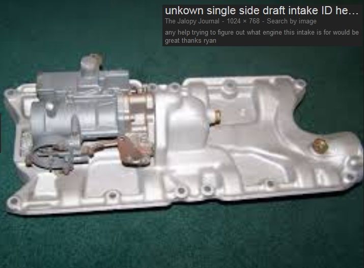

can the main jet @ .802 tell us anything about how this YH might perform a sextet on our motors? (or R we back to trips but side draft)?
U or Mike's Carbs sez this Carter wuz used on 'Vetts - 1 per 2 cylinders...
Is it a good option for the "1 per cyl" falcon motor? if so which of the 6 motors...
"...many little Ford six boat engines..."
Posts: 6770
Post #28 by xctasy » Sat Aug 12, 2017 9:03 pm
Its a little to big to fit on the passenger side, but if its "rib-caged" with a six fingered Paul Knott style 61 Falcon 170 steel tubes to the log head, then you'll get six of them fairly easily on the drivers side. You support the whole shebang on some metal supports so the carbs don't fall off over the the bumbs of AirBorne Early Bronco Busting trail journey's

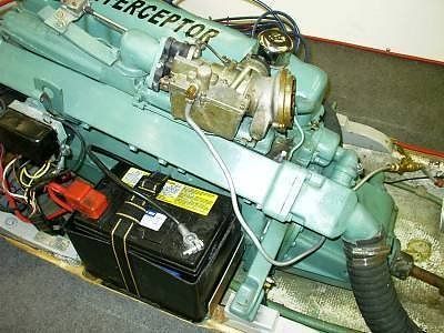

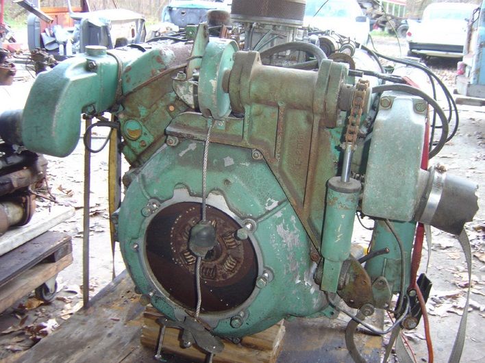

chad wrote:I grew up on the Chesapake Bay (1952 - '80) and saw some teake, mahogony and brass outfitted "skiffs" with motors
like those in the area. I wonder if there is a connection. The engine pictured is the 200?
Yes, the connection is this.
While YH Carter was used on all the sports Corvairs, Corvette L6's, the Nash Healy, and then later Marinised Slant sixes and, IIRC, the later Clark and Hyster Forklifts. Due to space limitations of the Tea Pot 4-bbl carbs, Y blocks wouldn't fit boats easily. So Interceptor cobbled up the YH Carter to fit in the lowest slung intake manifold ever.
Interceptor "Eaton" Inboard I/0 engines till about 1964,the Ford I6's and the Y block V8's all had YH's in single of dual form.
(Note Well Interceptor opted out of the YH Carter totally when the 221 V8 came in for 1962,
but that engine was very compact; one YH Manifold was made for the 221, and the planned Sunbeam Tiger and Interceptor SBF V8'S. Fords Autolite 2-bbl carbs were small enough to just fit under the engine covers or hoods)

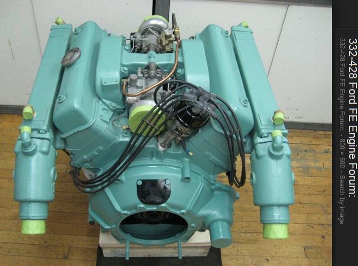

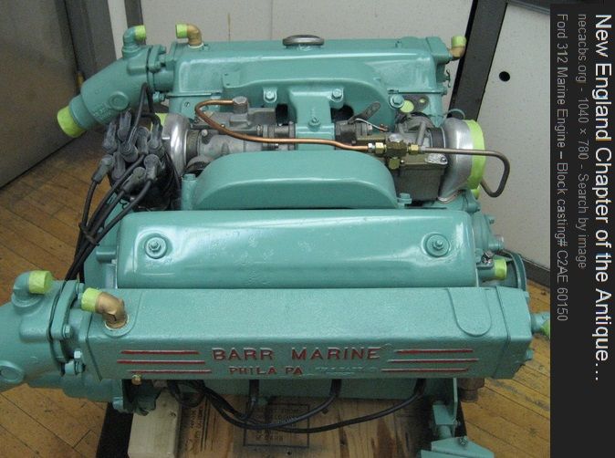

https://www.youtube.com/watch?v=AuhKPyhdqKE

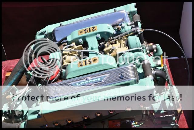

The Dearborn Marine Interceptors were exy little engines. 215 HP gross in the 312 wasn't much chop compared to a Fuelie 327, so evn though they were built to 1964, the Y's were glorious looking, expensive anachronisims.

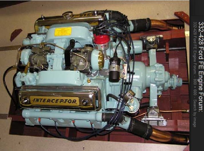

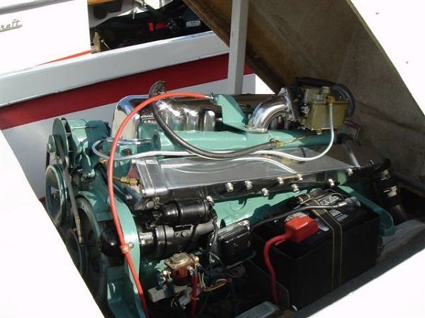

http://m571.com/yblock/intake.htm
http://m571.com/yblock/intake.htm wrote:Interceptor
Interceptor
This marine manifold used Carter YH sidedraft carburetors to keep the installed height to a minimum. Some installations used only one carburetor. YH sidedrafts were also used on turbocharged Corvairs, 215 F85 Oldsmobiles, Corvette “Blue Flame” 6s, and Nash Le Mans 6s. Exhaust heat is passed under the cross runner of this unit.
Interceptor on Thunderbird
This beautiful Interceptor intake installation on a Thunderbird was accomplished by Gary Hartzell of LA Mesa, California.
In Gary’s own words:
“Wanted to do something out of the ordinary. Went to the Goodguys show at Del Mar last weekend (first show) and stumped a lot of Ford know-it-alls!!!!! One guy asked if I had to do anything special to make it run right and I told him I had to fill the radiator with salt water!! I had to fab my own necks to the radiator, but the installation wasn't too difficult at all and the results were well worth it.”
chad

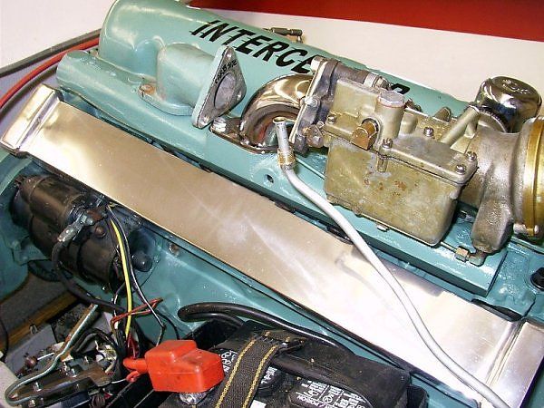

The Interceptor Y-block intake was born a Marine V8 intake, and had to be converted to a pro street style twin line to fit an automotive Thunderbird 312 Y block.

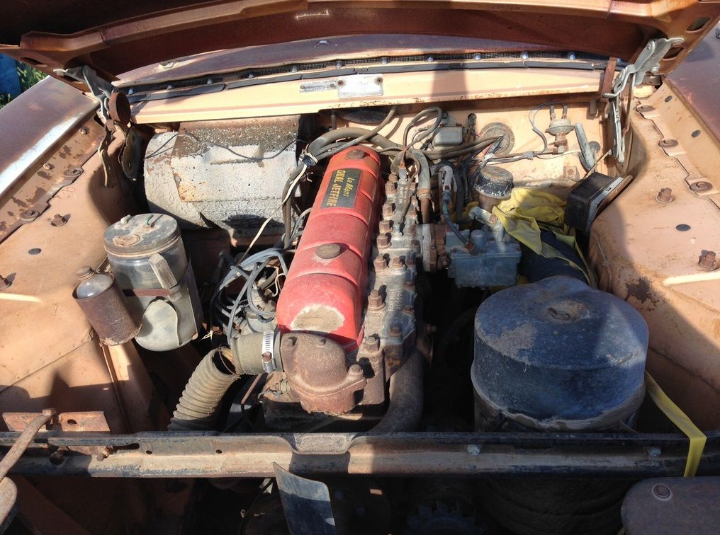

Back to the YH's....Mopar Slants weren't YH equiped if the engine was mounted at 30 degrees,
http://www.hotrod.com/articles/mopp-111 ... ep-six-001
even if it was canted a further 50 degrees to a wacky 80 degrees, just 10 degrees of being a flat six of sorts.
It still ran the 2-bbl Carter BDB carb.
But the Nash Ambassador Le-Mans was.
More on the single YH carb Interceptor 100 144cube engine
Gray Marine Co. used dual sidedraft Carter YH on the AMC 327 engines

re-viewin da pic in ur #26 post above, X, I C a way 2 use the YH in "1 per cyl".
(They use a side draft like a down draft - to me, anyway. Again may not have the proper nomenclature).
If placed on a 90* adapter (like on the #26 post) the log could B retained. The carbs could B arranged left/right/left, etc all the way down the log.
I believe this may take up abt the same hight as my RBS (or the other low mount carb: 1100) plus___?___ inches.

Nash built 3 series of cars during the early and mid-fifties; Statesman, Ambassador, and Rambler. Rambler had their own styling; Ambassador and Statesman lines were hard to tell apart.
1955 Statesman Six Dual Carb. Figures same as the standard six but with dual Carter single barrel carbs. Front carb was a YH-973S; rear carb was a YH-974S. Brake hp 110.
1955 Ambassador Six. Inline, OHV. Displacement 252.6 cid. Brake HP Brake HP 130. Carter Single barrel carb YH-895-S. 1955 Dual-Jetfire Six. Displace 252.6 cid. Brake HP 140. Carburetors same as the Statesman Six Dual Carb.
1956 Ambassador Six. Displacement 252.6. HP 135. Carter single-barrel, Type YH-2368S.
1956 LeMans Dual-Jetfire Six. Displacement 252.6. Brake hp 145. 2 Carter Type YH-2396S carbs.
There were single YH Dual Jetfires too
2. Then two up high. (front to back like the 215 Interceptor and the 100 Interceptor).
