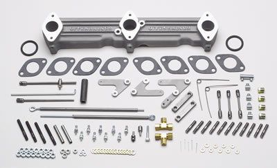

1. Offenhauser triple carb manifold #5017 (Officially discontinued)
On C0 OE 6090 head, no capacity
See the water heating conduit or the aluminum casting runner tract, the reduced height through bolt bosses, and no Offenhauser.

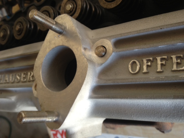

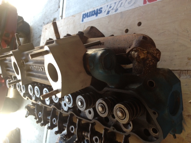

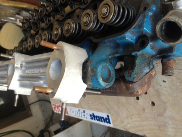

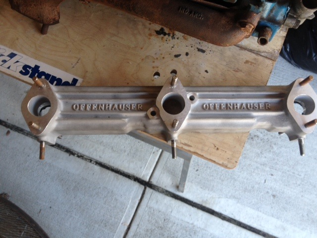

3. 5205, it sometimes won't work with the C3 OE heads without work...

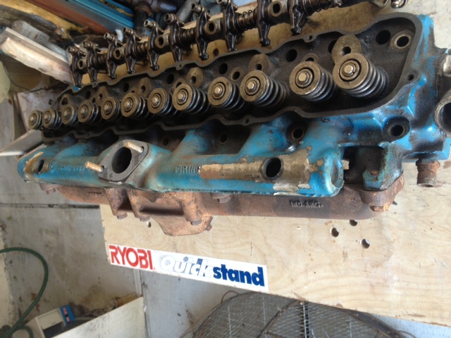

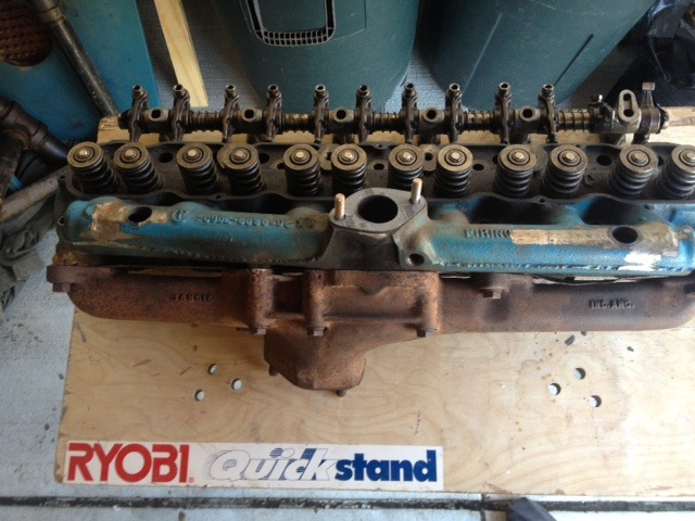

I found a C3 OE 6090-D Cleveland Plant foundary head....Member 61Falke's tried putting an Offy 5205 on it.
It was suggested it might be a C3 OE 6090 D "144" head; I'm sure it is.
Offenhauser triple carb manifold #5205 did not fit it, but it was close. You do get problems like this.

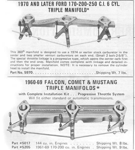

Regards the 5970 Offy, Summit screwed up the listing Applications....
Url ----> https://www.summitracing.com/int/parts/ ... plications
Application list wrong, says its Small bolt spacing C0 OE "170" head before the large C9 flat top revision, but clearly the later DE "170" log design.
This is for 1974 or earlier carb stud spacings
Offenhauser triple carb manifold #5205 Large bolt spacing post C9 Flat top log , Large bolt spacing D8 dog turd on wards
Url ----> https://www.summitracing.com/int/parts/ ... /year/1969
Application list right, Ford: 1960-69 170-200 Falcon 6 Triple Manifold (5205), but wrong for any year 144 head. Clearly for Small bolt spacing C0 OE 6090 144 head before the large C1DE 6090 "170" cubic inch revision
And your 144 head to 5205 Offy missmatch... care of the HAMBERS at jalopyjournal...some of whom walk umungst us...
http://www.jalopyjournal.com/forum/thre ... ed.799127/

Any pics of the underside of the Offy intake? I'm curious how the outer carbs seal to the top of the log. What are the carb spacing dimensions between the carbs? It wouldn't be hard for me to make patterns to cast a manifold for either the 144 or other small 6's.

Heres the #5017 Offy kit.

Way back in 2003 from Jim Smarts http://www.mustangandfords.com/parts/mu ... nce-guide/
CNC-Dude, carb 1 and three lines up with the head bolt centres which are 4.08" cylinder to cylinder, so that makes it 4 times 4.08, or 16.32" from front to back (414.528 metra mathingamies), or 8.16 inch centers.
Any C9 or later head will work fine. Chances are any head needs a valve job. Up sizing the valves and/or putting in seats isn't rocket science for the machinist. The 'hardened' seats in a lot of the oem heads were induction hardened, not inserts. According to some I trust, it really makes little difference with today's fuel and good ford castings. Any increase in log volume is lost in the design.
The 5017 Offy adaptor. Some more pictures.
Like the Ford Industrial 170 and 200's made between the late 60s and early 70's for threshers and wood chipers and standy engines, the Governer forced the carbs to be swung thru 90 degrees, which is why all small Ford sixes have alloy adaptors.
Carb placement isn't as much of an issue with the three entry points for fuel air at wide open throttle.
(last pic)
Don't think I've seen em turned 90* like that…
in such a case the linkage needs total re-work? Y turn them (guvnah - never needed politics /or/ automobiles) like that?
