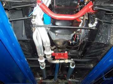

Has anyone put duel output headers with duel exhaust. got any pics of the belly Where did run it. What was placement of mufflers. My muffler now is between the gas tank and back seat. Did u do anything for heat transfer?

one picture is worth ...
'61 Comet / 250 Hooker 6602's / Smithy Mufflers /Summit preformed Mandrel bends & SS Flex Joints and rubber hangars... (highly recommended)
'63 Falcon / 170 Hooker 6601's / two OEM six mufflers (quiet DD)
.: they do hang kinda' low..

sprogg777 has a 1966 mustang 200ci with c4 transmission :wink:
If you are in the states where its salted, you might need to consider your options. wsa111 has some pictures of his.

71 Maverick with a 250 motor and hooker super comp headers.
1971 Maverick, 250I6, crank knife-edged, Clay Smith 278 solid cam, .040 over 255 V8 pistons, 10.5 to 1, Custom 500 Holley 2V on Classic Inlines Aluminum cylinder head, 1.6 rockers, Hooker header, DUI dizzy, C-4 w/2800 stall, 8" 3.55 det locker
