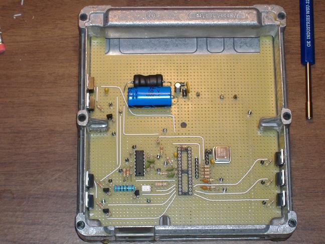

The controlling system I'd use is the very simple Arduino PWM computer, about 65 buxs, and a cat mounted O2 sensor, and front head stud mounted knock sensor.

People I work with on other forums just hack into old EECIV BOARDS AND run the basic systems

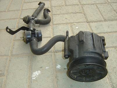

The O2 sensor hookup, easy. Six pack of catalyst, heat shield and O2 sensor pictures! The cat is a big old thing, but they make a much better replacement, and the exhaust is efficient...
"IMG_6861"
"IMG_7222"
"IMG_7223"
"IMG_7224"
"IMG_7227"
"IMG_7228"
The O2 sensor has two wire, white /black stripe, yellow/ black stripe link-up, with 2-3/8" probe into the catalyst distance, its mounts at about 3-1/2", and about 4 -3/4" long tip to outer heat wrap. Std a spark plug type.

Now, AIR: This is a Secondary air injection Ford calls the Thermactor, short for Thermal Reactor. CA vehicles are installed with it as standard. Air Injection Reaction is what it stands for.
The thermactor system consists mainly of the air pump, the air pump diverter and bypass valves, TAB and TAD solenoids (if equipped) and the catalytic converter.
AIR BPV: Air Bypass Valve (aka Thermactor Air Bypass TAB)

Since most people yank out the Air Pump (evil b :nod: $+@rds ) the system is a lot "simpler". I never have. Doesn't make me any beter than anyone else, but the Secondary AIR EGR system is like this
At the back, Downstream after Primary catalyst AIR, beside it, Upstream before catalyst AIR,
and then TAD Thermactor Air Diverter Valve
and an TAB Thermactor AIR BPV - Air By Pass Valve
and a stanadard 31 pound per hour Air pump. On 4.9's, 4.1's and V8 4.2/5.0's, always on the passenger side, but on the Fox 3.3's after 1978, on the drivers side. Some 1978 3.3 Granadas, Mavericks had them on the passenger side.
