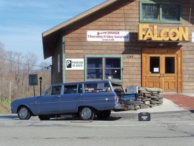

I've been following the suggestions for guiding a low-budget rescue of a reasonably intact old car. Here my $ .02 :
.. for over 15 years I've been running a patched up - bondoed' '63 more-door wagon with a 170/2.8. It used the worn but servicable original ' 63 170 for @ first 5 years while I upgraded brakes , broken springs, sloppy front suspension, fuel tank , etc, working out common recovery gremlins.
When I could afford it, eventually swapped a less expensive NWC ("Non-World Class") '84 V8 geared T5 keeping the original 3.50 rear axle. This low cost setup makes for excellent modern drivability without major mods or money. The 3.50 rear and T5 gearing lets the 170's available torque accelerate well and with the mentioned .63 Overdrive, easily cruises at modern interstate speeds. The 'new' 170 is inexpensive untouched Craig List (V8swap) 1971 Maverick block/cam/etc with only "mods" being a D7 ('77) cyl head milled @ .070 to a combustion chamber volume of @ 48cc's. An E-Bay - Merc' Capri 2.8 V6 Holley/Weber 2Bbl on $15 adapter and dual out header complete the engine 'mods'. Someday I will swap out the OEM points ignition - IF they ever have a problem...
The capable '63 is basically my fair-weather daily driver with the necessary mods being shoulder belts from the '71 Maverick and the dual MC . Original drums , the Mavs' 4 lug14" wheels with 215/70 14's, thicker front sway bar and rear air shocks flatten the old wagons' handling (and load carrying when needed). No intention or need for big-budget horse power or major mods in a good running mostly original car.
An observation over the years: these days the '63 wagon draws more interest at cruises than the big-block - big money - shiny muscle cars of well-off old timers from a long gone era fading from interest of 'millenials' who don't even remember what a Pontiac was ...
