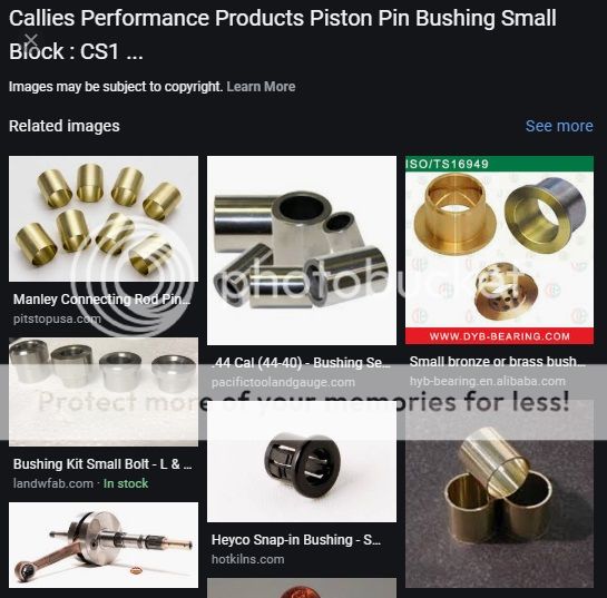

The 4.375 and 4.40 bore center Ford and Chev Small blocks have a 0.75 to 0.866 Cylinder 1 to Cylinder 2 spacing like nearly all common crank pin 90 V6/V8s or 60 degree V12's.
The rod offsets are offset about half that left to right cylinder spacing.
The old Vortec and earlier SBC derived 90 degree V6's Chev's have a rod different offset to a 305 350/400, about 180 thou on some.
There is a large amount of redundancy in the wrist pin part of the beam of even a 5.09 302 SBF or 5.115 289 SBF rod, and an option of back sizing to 0.911 or 0.927 in the wrist pin by oversizing the wrist pin, and then put a brass insert in it.
The Mitsubishi or SBC bushing allows a 0.866 or 0.927" wrist pin to fit in a re honed rod.
