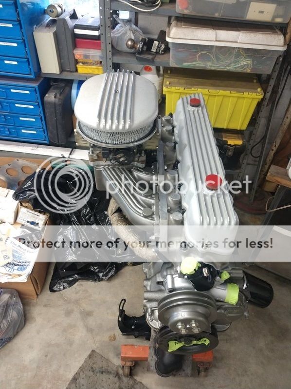

Up date with pics. I changed my cam from the Schneider cam 262/270 112 to the Clay Smith 274/274 110. Hope fully have the engine together this week. Then I get to figure out a new A/C bracket and engine mounts. I also found a set of NOS Hooker competition 6602 headers. Looks like I will me running Holley Sniper EFI. Story will be featured in Mustang Monthly.

Hi, really nice build.
I'd bet you'll pass 250 HP.
I'm thinkin' the rest of the car is screamin".
What's up with that bell housing?
Good luck

I will be selling it with the T5 adapter, clutch, flywheel and block plate.

10.5:1 w/ a 250 is a big ask on pump gas. I see you've got an aluminum head and you're using a pretty big cam. With 50 1/2 cc chambers and stock size dishes you must have alot of leeway in deck height. Did you deck the block at all? How fast are you planning on spinning this beast? Did you drop the efi plans? Imo, ol boy screwed the pooch when he made the head patterns w/ 54cc chambers.

The block has been deck to .040. Plan to make red line 6000rpms, I will be running Holley Sniper EFI. I never planned on building a 250 when I bought the head. So that is why I had Mike mill the head a bit.

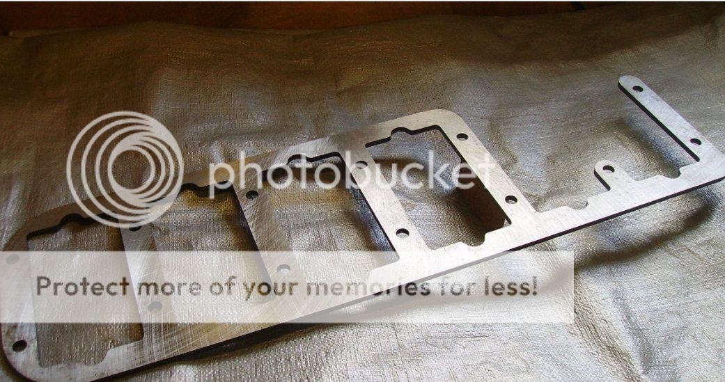

Here is a pic of the crank gear with a new notch to advance the cam. Not sure how he figured how much to do. But it worked. I measured for my pushrods and will have them Tues. Hopefully next week I can fit engine into the car. I will update with how I end up mounting engine.

Post #23 by rocklord » Sat May 04, 2019 12:03 pm
Nice build.
Where'd you get your export brace?

I havent seen anyone ask yet but where did you get that main girdle from? Import from AUS? id be interested to know.

Post #25 by xctasy » Mon May 06, 2019 2:42 pm
Nice work, 65-coupe.
https://www.ebay.com.au/itm/Ford-250-4- ... 1663065033
Seller information
ford-speed (1566 :shockin: )
100% Positive feedback
Like the Holden 308 timing chain for the 302 crank gear Mike 1157 uses, you can use parts from other engines.
Here is former forum member MarkZE's fully enclosed version.
http://fordcortina.com.au/newforum/inde ... opic=260.0
ARP studs, and a girdle which clamps over the caps. The caps are now machined flat to suit. The following measurements applied to the stud length:
Block thread depth: 1”
Main Cap height: 2.2”
Girdle thickness: 3/8”
Nut and Washer grip length: 9/16”
Exposed threads above nut: Approx 3/8”
A 7/16” UNC x 4.5” long ARP stud will be required. So far I am told a 308 Holden V8 head stud should be the right size and thread to suit.

Post #26 by 65-coupe » Mon May 06, 2019 9:36 pm
62Cometman wrote:I havent seen anyone ask yet but where did you get that main girdle from? Import from AUS? id be interested to know.
I ordered it off Aus Ebay. it included ARP studs with the kit.

Post #27 by 65-coupe » Sun May 19, 2019 5:50 pm
So I finally have the engine in. I did have to modify my trans cross member. Which included lengthening the bolt holes and cut and weld the e-brake bracket. I have it as low as I can get it with it not hitting the steering center link. I have 2 1/8" of clearance from the water pump to radiator. I will be running one 16" electric fan and an 8". I will install my hooker headers after I break the cam in. then install new 2.25" exhaust. Still have to figure lower radiator hose and redo the A/C lines for a cleaner look. My 200 A/C bracket will work and line up. Should have my 3G alternator and mini starter this week.

Post #30 by 65-coupe » Thu Jun 13, 2019 7:30 pm
ITS ALIVE. We made our own Frankenstein run stand. Should be back in the car next week. I will install the Hooker headers when we install in the car. Link is to VIDEO of it running.
