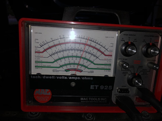

So it is most definitely flooding. I pulled the plugs and they were black and wet. I was able to snag a tach dwell meter per Bubbas suggestion and had some time to hook it up and test it out. Still getting used to the ins and outs of it but I took a picture of it see below. Looks like I'm at 40 degrees dwell, if I am reading it right.
I did not have enough time today to set the dwell. I will continue to follow the steps Bubba has listed. Thanks for the support.

:beer: Great Tach / Dwell meter! And your real close on the dwell reading try adjusting the point gap just a little to get to the goal of 38 degrees. Good luck :thumbup: :nod:

to know which way to adjust
remember :
dwell too small = point gap too big
and vica versa
MustangDadDrake

PS - GB500 thanks for the tip it helped me set the dwell.
