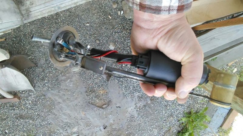

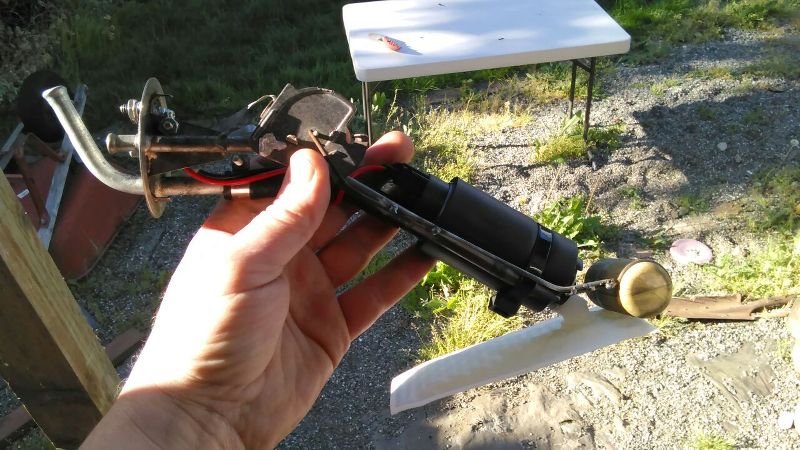

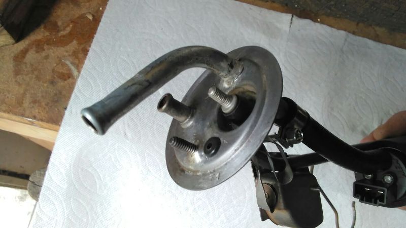

If you are seriously considering going to efi I'd first try and add in a return line and install a regulator with a return line to the tank with the mechanical pump setup. If the problem is still annoying you then you can add in the pump you'll need for efi and already have the right regulator and return in place to keep the carb at 4.5# or whatever with the 90 psi pump efi will require. Otherwise you'll be buying another pump and reconfiguring when you inevitably decide to go fi, be it holley, fitech, megasquirt or what have you. Holley has a drop in sniper sender/pump for 60-65 falcons(they claim) for $335 but those don't have a return line, you could easily solder one in to their sender though from the looks of it or plumb it into the vent or wherever makes sense. I think tanks inc makes an efi tank for your application(or falcon at least) but with the pump and sender it's more than $500. I took my old sender and made a pump with a return line for about $150, but I had the sender laying around. I found a good pump to buy, AEM 50-1000, moved the rheostat and changed the geometry/extended the float arm with a bit of stiff wire. I bought a 25' spool of 3/8" steel fuel line(most of which I still have), clamps etc and I found the right pickup sock for it, Delphi# FS0103. I haven't installed it yet though. I used a rubber grommet to insulate the hot wire to the pump and seal the hole around a short ss screw stubbed through and washers locks and nuts on either side. I added a grounding stud threaded thru and soldered on. The old supply is the return. I don't think it's sketchy.
I layed out the old pickup point and designed it to meet that point, the sender still work, and the return inject at the sock. But above all it had to fit through the hole. Wix# 33482 with an Aeromotive# 12701 is the right filter and frame clip for this setup, post pump right off the tank then the normal filter at the carb. And don't forget your fuel pump block off plate like a SUM-402035 if/when you go to an electric pump.
