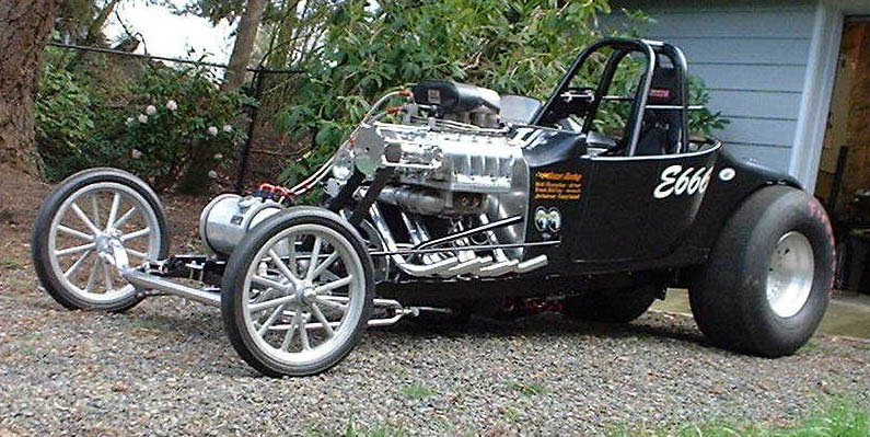

This is my idea of a GM L6 gasser. How 'bout shoving a 671,653 or 696 on your Hemi 6? 30 degree engine tilt puts a pre'69 Chrysler Slant on things, doesn't it?

:? thought about that long and hard.a performance place close to me has a wade,an eaton an a few gm blowers for the right price,but at the moment i'm putting out a good 350hp(reliably)and with an engine rebuild i can easily bump that to 400.and frankly any more than 400 won't go any faster (i do'nt want larger tyres as i want to keep that '60's look)and i can pull 12.6 now. with 400 i might be able to touch the 11's(but with street tyres?)aother reason is i do a lot of miles(going to various rod runs, around the country, and the blowers i've had over the years tend to wait till you are lots of miles from anywere before they start to make awful noises)but for smaller less powerful motors they are the way to go(such as my son-in-law's holden)all though naturally asperated 300+hp is achivable with all the parts avalible. :) steve
