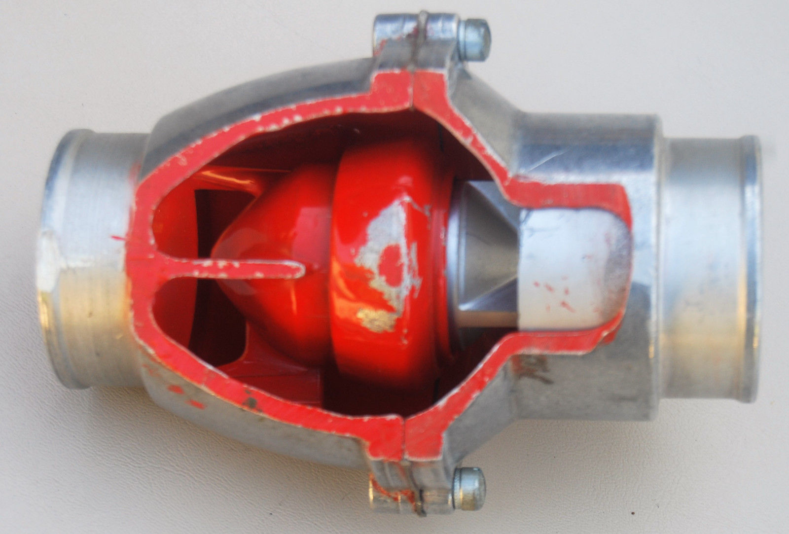

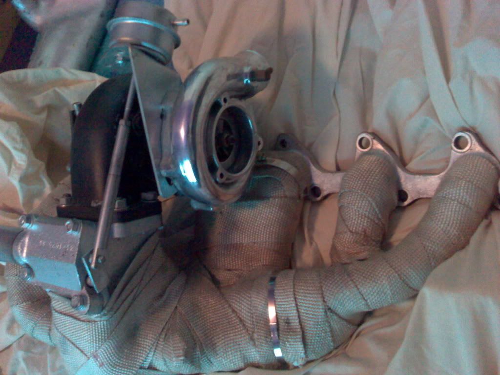

The manifold is from an Ak Miller 240/300 draw through setup.
It uses an IMPCO inline boost controller on the outlet of the compressor. I want to use a wastegate instead. I looked at using an adapter, but it drops the turbo down too low which causes the compressor to hit the motor mount.
An alternative is to use a stock HD manifold and a J-bend with the wastegate attached right below the turbo, but I'd rather use the original manifold unless the new wastegate location won't work.

What was the problem with the IMPCO inline boost controller on the outlet of the compressor?

From what I've read it's restrictive even when fully open which in turns heats up the air mixture. Here's what the inside looks like:

Xctasy, thanks for the info. For the past few years my plan has been to use my almost 40 year old Ak Miller draw through turbo setup on my latest 300. Getting rid of the IMPCO boost controller and adding a wastegate has been one of my priorities.
But after reading up on wastegate locations I've decided that trying to add a wastegate to the existing manifold is probably not going to work very well. And although the draw through setup worked well in years past, it did have a few issues, like flooding. With the turbo down low the fuel had a tendency to pool in the compressor when first starting. Pump the gas a few too many times and you'd flood. Then you'd have to wait for the fuel to evaporate before trying again.
So I've decided to stop trying to make the Ak setup work and instead I'm working on a blow through setup. J-bend out of a HD manifold with a wastegate connected to the J-bend. Offenhauser intake with a Holley Sniper EFI 4bbl. That's the current plan. I'm sure I'll have more questions.

i would run the wastegate and close to the turbo as possible. by placing it there you are having a majority of the exhaust passing by the turbo still. i would place it right under the flange. that is what i did on my turbo 200 setup

One would think that the bottom could disrupt flow smooth flow to the turbine, But it is the preferred location for '' waste gate priority'' placement to prevent boost creep...If the bottom gives you easy oil drain and other piping, I would go with it.
Any members have any other thoughts on this ?

So my thinking is with the AK system the turbo bolts right direct too the bottom of the manifold, this seams to be ideal. What about making a spacer plate to fit between the manifold and turbo to mount the blow off valve in?

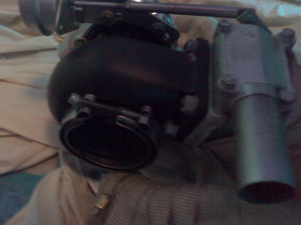

curts56 wrote:Attach the wastegate to the bottom of the J-bend. Would there be any performance benefit mounting it on the side of the J-bend verses the bottom?
drag-200stang wrote:One would think that the bottom could disrupt flow smooth flow to the turbine,
I'm also thinking the bottom would disrupt smooth flow to the turbine.
If the wastegate is large enough there shouldn't be boost creep with a side mount.
Re: Wastegate Location
I wish that would work. Unfortunately the compressor was already close to hitting the motor mount. Not enough space to move it down any further.
Side mount shouldn't be a problem so I'll give that a try.

I am ok with side mount...Looks like your waste gate is 38MM ...I would make the stub out inside diameter no smaller than the inside diameter of the waste gate flange.

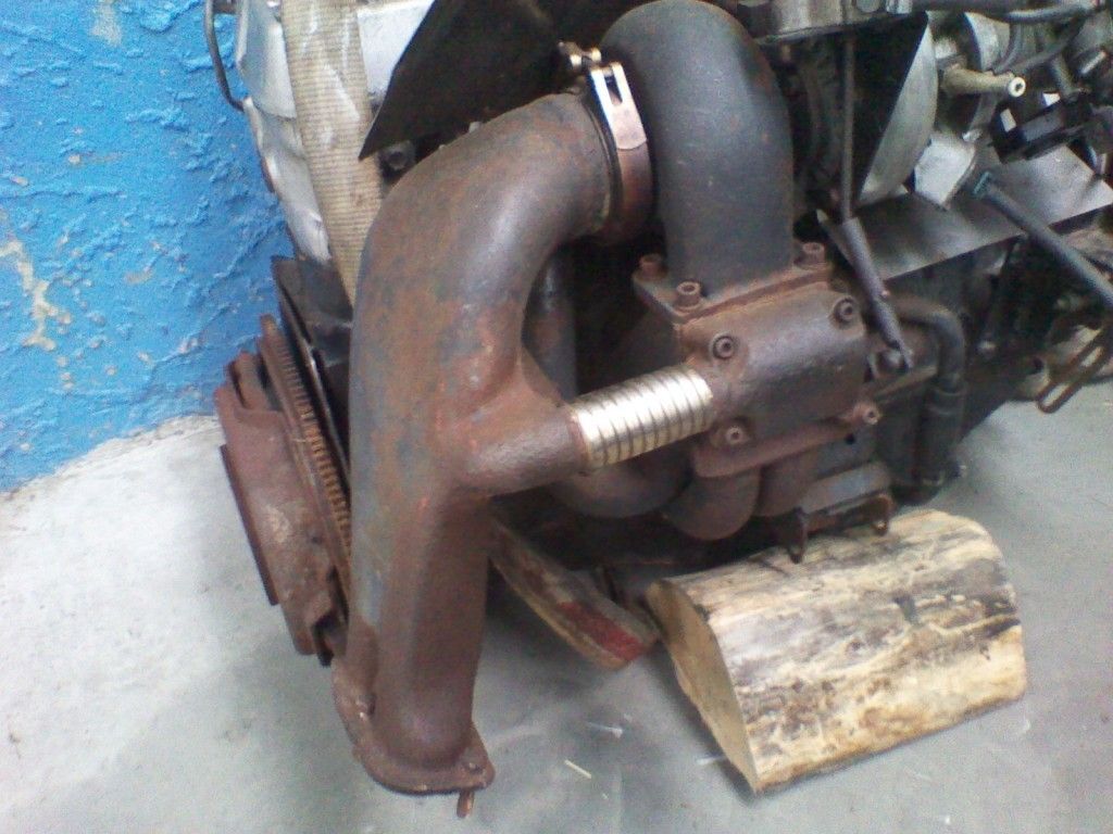

You will almost 100% get boost creep. You have 4 of the 6 cylinders rushing past the turbo port which inturn is going to keep giving the turbo exhaust pressure. How much boost creep you will get is unknown but you will most likely have some.

thatblue_67stang wrote:You will almost 100% get boost creep. You have 4 of the 6 cylinders rushing past the turbo port which inturn is going to keep giving the turbo exhaust pressure. How much boost creep you will get is unknown but you will most likely have some.
Not sure I understand , is this statement applied to pic in post # 1 or #10 ?

drag-200stang wrote:thatblue_67stang wrote:You will almost 100% get boost creep. You have 4 of the 6 cylinders rushing past the turbo port which inturn is going to keep giving the turbo exhaust pressure. How much boost creep you will get is unknown but you will most likely have some.
#1

if he goes with the wastegate on the j-pipe that location would be be the best. only better location is on the actual turbo housing itself but not necessary

In addition to all the other guys advice, drag-200stang's advice is right.
Like this
turbosix had the same process.
Lincs200 used the same idea.
/viewtopic.php?f=22&t=24859
The postive corntrol of a wastgate is the very best, and it must be upstream of the exhaust, with all pulses from the six exhaust ports feeding the turbo. Anyhing else will not work well.
See 66Sprint6
viewtopic.php?f=22&t=70797
Like this
Post #35 by Linc's 200 » Mon Jun 13, 2005 wrote:Wastegate:
It was the only place I could put it and not hit anything.....not too bad for a few hours work. Nice to have a TIG welder.
See 66Sprint6
66Sprint6 wrote:Right after posting up about the latest tweaks the UPS guy dropped this sucker off.
RJC's 3" downpipe flange with larger wastegate puck. Gonna be a bit of work to get it all sorted but I cant wait to get to it. Should free things up nicely behind the turbo and allow me to rid some of the small bottlenecks in the setup.

I really appreciate everyone's input! I'll post some photos as soon as I get time to weld on the wastegate flange.
