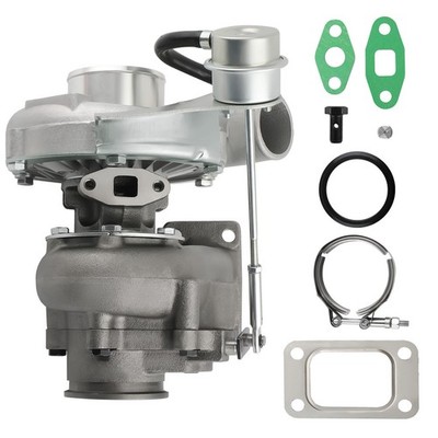

Does this turbo have the correct specs?
Yes, it looks like it will work.
Just don't know for how long with only a 270 degree thrust bearing.
All good quality journal bearing turbochargers use a 360 degree thrust bearing

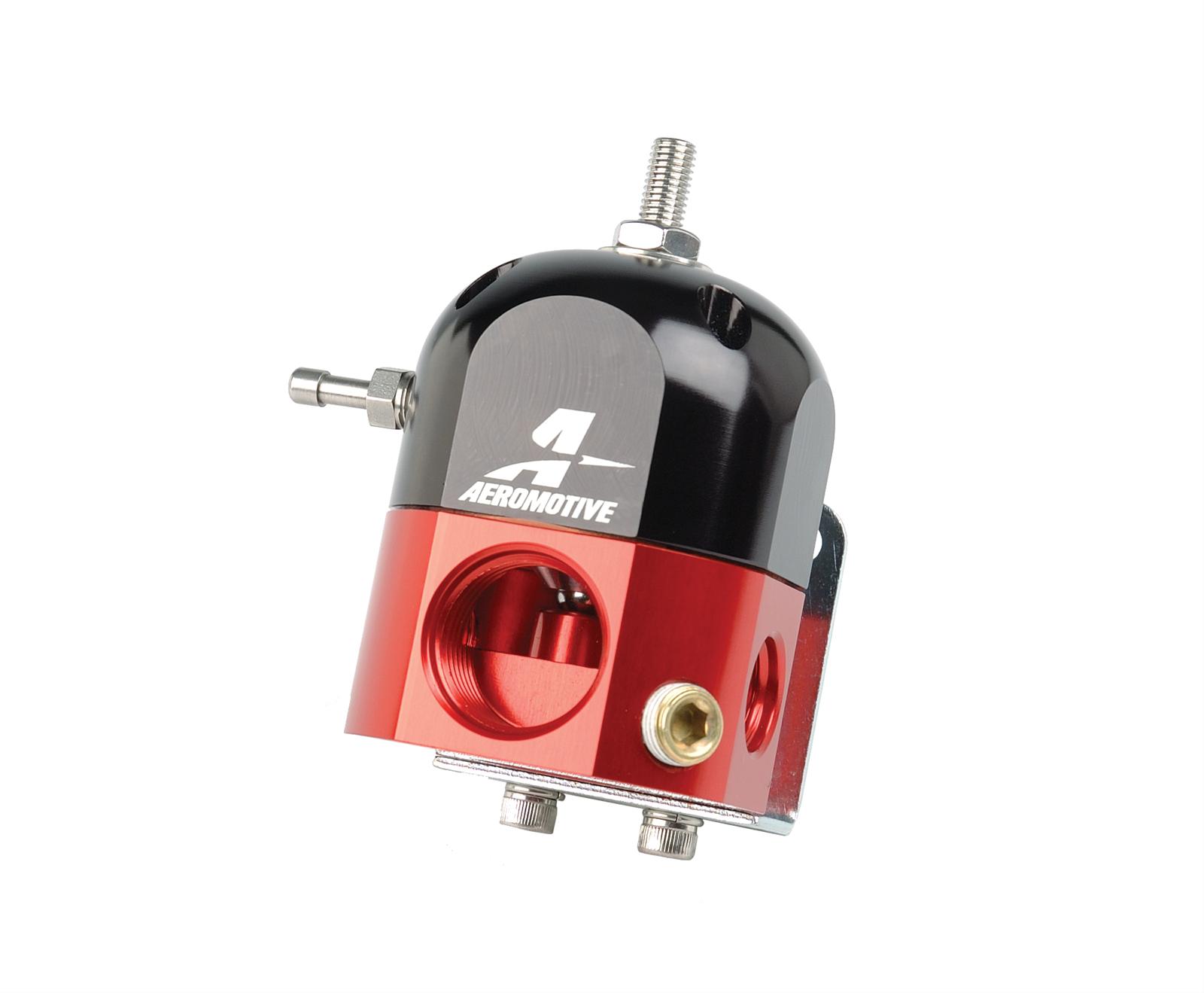

The fuel pressure to the carb needs to be boost regulated so the fuel pressure is always 5 to 6 psi above boost pressure at the carburetor.
As an example, if you run 10 psi of boost the fuel pressure should be 10+6 or 16 psi.
An electric fuel pump with a boost referenced pressure regulator does the job.
for Blow-Thru use, adequate Elec fuel pump and the aforementioned' Boost Referenced Bypass Fuel Pressure Regulator is needed with the regulator return line back to the fuel tank. regulators are available made for carb'd forced induction with boost reference carb pressure and fuel injection elec' fuel pump pressures.
Vac/boost line from carb to regulator adds equal boost pressure to @7lb base carb pressure with boost as needed'. Boost Reference Port added to 7448/350 2300 intake for carb intake horn pressure.
