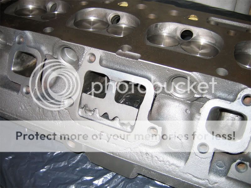

I'm currently going through this exact same excersize myself. I'm going to go with an Autolite/Motorcraft 2100/2150 2bbl, 1.75" intake/1.50" exhaust, hardened seats, new valve guides, new springs, and doing a port polish job.
On the porting effort, I cleaned up the combustion chambers. I'll be doing a polish job on them shortly with the Dremel. When I was done with the rough cleanup, I cc'd the chambers and I'm sitting at 61 cc. I'm going to have the head milled 0.070" which should net me in the 9.3:1-9.5:1 range, if I did my figurin right.
I matched the exhaust ports to the gasket, leaving them just slightly proud on the head (still have stock exhaust manifold). Right now I'm polishing the ports then will start in on cleaning-up/polishing the exhaust pockets. On the intake side, I'm just going to roughly clean up the casting flash and shape the valve guide bosses. I'm not going to bother trying to do much of anything to the log as that seems like a significant amount of work for marginal improvement. If I can't reach it from the combustion chamber, it won't get touched.
I got a quote from a shop here in town for all the machine work. They came back with something like $600 to hot tank, magnaflux, install new guides, complete valve job and cut for oversize valves, mill off 1 bbl boss, and 0.070" milled.

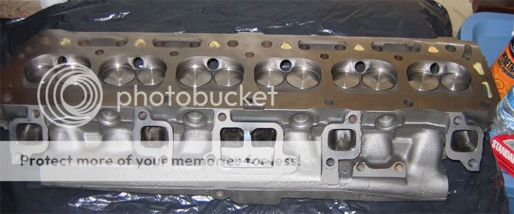

The FalconSixPerformance manual helps think through a reasonable build schedule. Head and other work can start with measuring current 'CC.s of compression chambers of head used. Confidence in projected CR - static and dynamic depend on reasonable figures for the cam selection and machine work. Drivability upgrades for modern times, , cruise and show or real hot rod six money, planning the basic engine work can optimize your goal.
sounds like a plan' , the .070 cut will raise the compression ratio to figure.
My '63 wagon 170/5200/T5 gets @ 25 MPG but the worked D7 head running close to 10:1 SCR (48cc CC's and metal shim gasket) uses 93 octane minimum... , the '61 runs race gas at the track with 274 cam / 500cfm+ 2Bbl / blueprinted HiPo 250 (bored to 258) ,will shift @ 5000 RPM.
v . Image . Image
.. machinist asked NOT to cut D6 250 head with OEM 62cc chambers at all for needed low compression project:

That looks like a 170 head. What size are the chambers now??

for Econoline et al '
That looks like a 170 head. What size are the chambers now??.
Keen observation! , the filled valve area give it away?. I think the uncut DODE (Maverick170) head measured 58cc' chambers. Image.Image
.. the pics' is from confirming combustion chambers volumes' for suitable head for low CR (@ 8:1 SCR) 250 project. Found D6DE uncut 250 head measured @ 62cc chambers.

Jackfish that's some nice exhaust port work.
Econoline your work in the bowl area is real nice.
