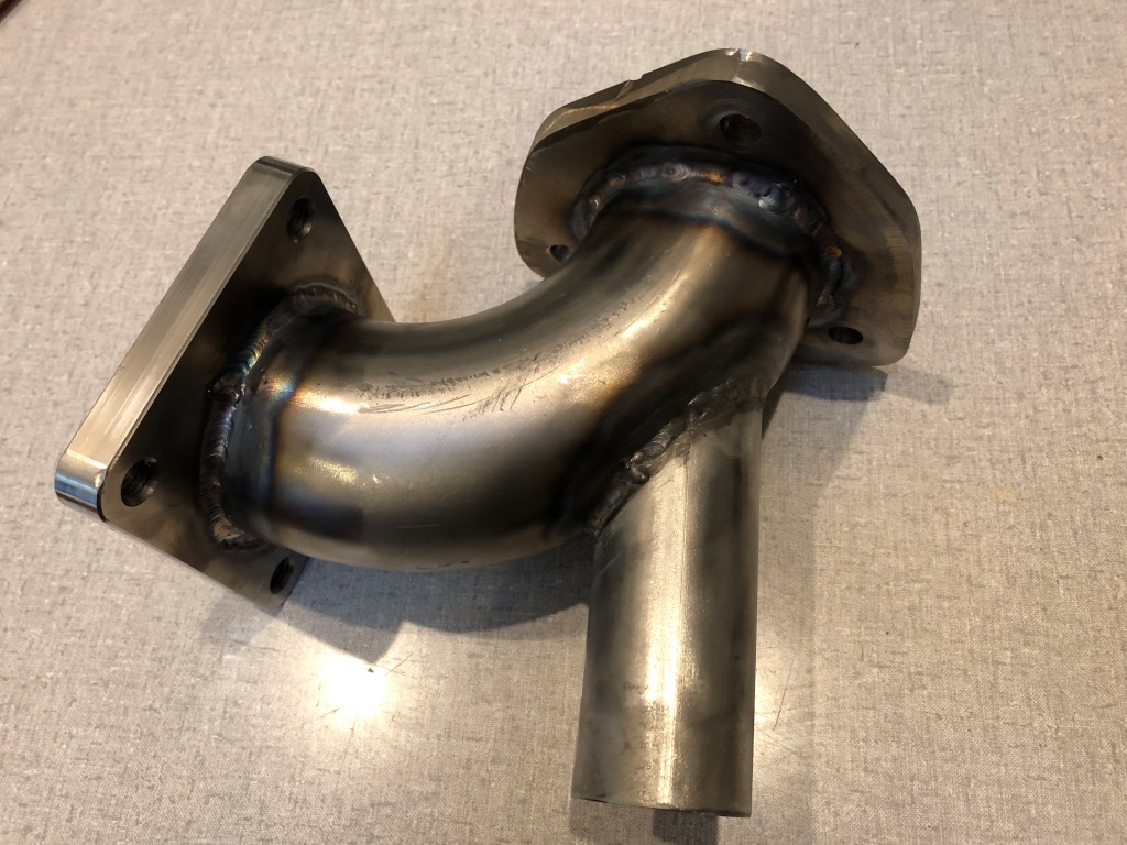

Post #17 by sdiesel » Tue Nov 05, 2019 12:54 pm
it's beautiful work on the assembly of the engine.
tell us about the Jay pipe, specifically how u attached to the manifold,
and how u support the weight of the turbo
curts56
Posts: 144
Joined: Wed May 26, 2004 12:15 am
Location: San Jose, California
Re: 300 Turbo Cam
Post #18 by curts56 » Sun Nov 10, 2019 11:23 am

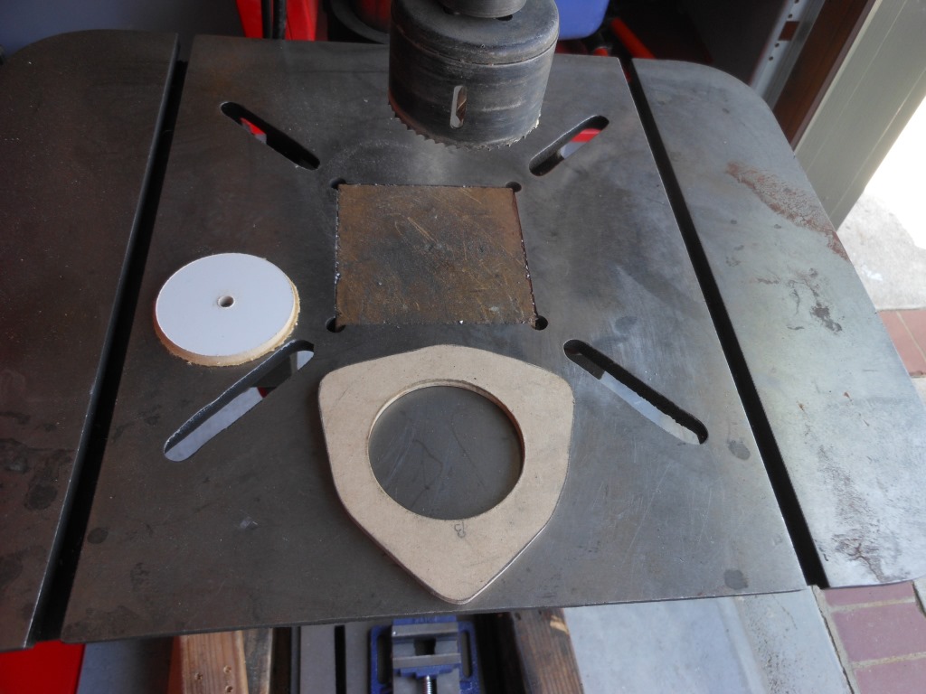

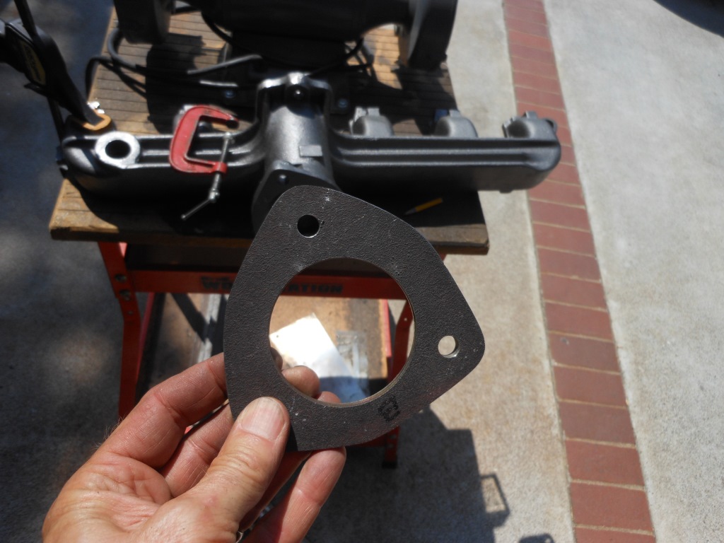

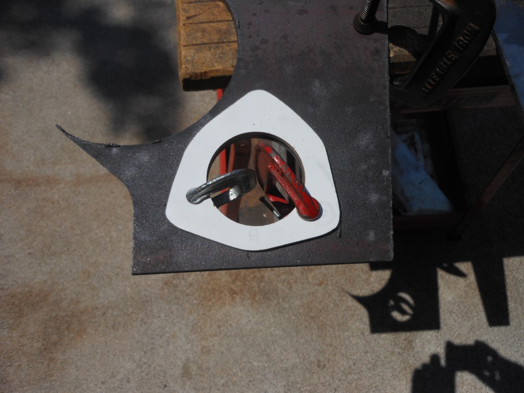

The flange is made out of 3/8" plate and mates directly with the flat surface of the exhaust manifold outlet. Hopefully that will be more reliable than a donut gasket. I made a template out of hardboard panel then cut out the flange using a plasma cutter.
The flange was welded to one end of a 2-1/2", 3" radius J-bend and the turbo flange was welded to the other. The 1-1/2" tubing is for the wastegate.
The HD manifold is very beefy so it shouldn't have a problem supporting the turbo.

Post #20 by sdiesel » Mon Nov 11, 2019 11:52 pm
yes, very pretty.
impressive.
I did similar, or had it done by a hand steadier than mine.
though I was in on the process.
a 2.5 pipe with a bead circumference-ing the j pipe, about 1.5 inches from the pipe's end,
my flange , available online , stainless, 1/2 inch holds the j pipe to the inside ledge of the manifold, by tightening the three bolts squeezing the bead between the manifold and flange.
I do not know if this will work, it should. but my concern is the weight will literally drag the manifold off the face of the head by simple dead weight.
the HD manifold provides for the pipe to be inserted into the manifold 1.5 inches or so.
having the flanges "face-mated", may expose u to leaks or warpath due to dissimilar metals reacting to extreme heat.
I install my manifolds with the engine laying flat on the engine stand, so I can eyeball the centering of the two manifolds.
I'm going to try:
use studs, bush the studs at their base, so the int/exh, manifolds are precisely centered around the stud.
then fab up the metal clips that will support the weight, because they reach down from the stud, and wrap around the bottom of the exhaust flange.
somewhere on here someone built these clips to nice effect.
on factory trucks the down pipe helped support the manifold assy. because it was essentially verticsl, and we'll anchored below.
I'm not so sure the exhaust pipe with a turbo, will as readily lend such support. I worry about failure in some remote location.

Post #21 by curts56 » Wed Nov 13, 2019 1:25 am
I plan on using a gasket between the flange and manifold, so that should help the dissimilar metal issue. I'll be making some clips like you. I'm going to mill off the heat riser "block" off the bottom of the intake manifold and install a plate over the exhaust manifold's side of the heat riser. So there will be no physical connection between the two manifolds.

Post #22 by sdiesel » Wed Nov 13, 2019 10:27 am
the heat riser is a headache for me.
mine is an open hole, needing plugged.
not easy to get a leak free seal.
on the outlet pipe, I urge u to reconsider.
examine carefully the outlet port on the HD. Does urs have a machined recess about 1.5 inches deep?
it's a very good way to guarantee u get no leaks if u can take advantage of the recess by 8 setting the pipe to the very end of that recess, up against the ledge left after machining was finished.
further, it aligns the pipe on the outlet same plane.
I wish I were allowed to post pics, I could explain so much easier
curts56
Posts: 144
Re: 300 Turbo Cam
Post #23 by curts56 » Wed Nov 13, 2019 9:14 pm
You mean like this:
The machined recess in my manifold is only around 0.5".
