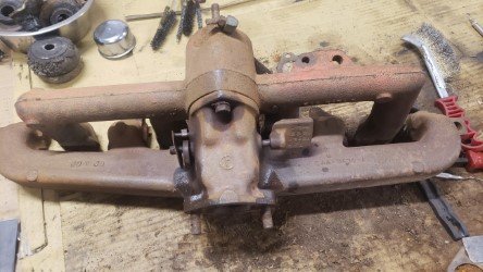

Also..found out the exhaust manifold is cracked....anyone repop them?

If the manifold isn't cracked too badly it could be brazed, or it could be a fine excuse to get headers,
I know someone that may have an exhaust manifold, it’s from a ‘61, let me know I could find out how much he wants for it?

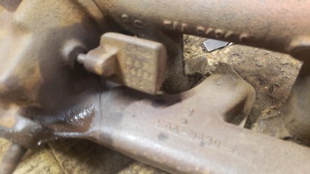

Well...I struck out with the manifold. I drove 2.5hrs each way...I inspected it and didn't see anything wrong. It is 10x better than the original one I had, but once I got home and started cleaning it I found a crack (Was hidden under dirt). Starting to think this might be the best I am going to find and I should just run it.
Thoughts?

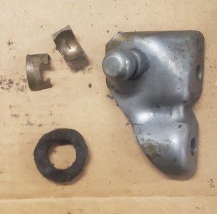

Getting close to getting everything back together, but need some help identifying the name of this part and where I can find new bearing and bushing. I checked my manuals, but can't find any pictures of it.
It mounts to the bell housing and connects to the clutch pedal linkage
