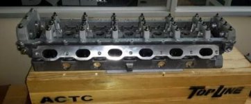

They make these heads for 3 other makes besides the small Ford six.
The old ACTC 3 liter Argentine roller cam OHV push rod Ford small six engines put out 380 hp.
There is no reason to sell them when 30,000 inline six fans buy tickets to watch them race.
I agree 100 percent. That is also where the money and development came from. They are not in it to sell and make profit.

Topline was a foundry hired the by ACTC.
Topline did not design or own the heads they cast them.
The process of the multivalves had begun in 2006 from a talk that Oscar Aventin - at that time president of the ACTC - and Juan María Traverso had held .
Immediately afterwards, an old project by Jorge Pedersoli came into the hands of Puma , who together with the specialist Nicolás Colloca , was responsible for carrying out the first developments.
Jorge Pedersoli was appointed by the ACTC to carry out the project in its 1st stage.
In 2012 , the ACTC changed course: it put Oreste Berta in charge of the project.
The ACTC launched the multivalve engines on March 22, 2015.
Ok, so there must have been drawings and patterns, cast boxes etc, Who did the machine work, it would have been extensive, then there is all the small bits needed. It would have been a big undertaking!
