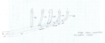

I have fitted a divider to a 2v engine many years ago and made a gasket to work with the new flange. It sounded different, but power wise????? Without back to back test your never going to know, I would say the difference would be very slight. I have sketched up a design to header to work with the 3 4 centre port, it only used 5 pipes, its very simple and is basicaly a streamlined version. Its much like those exhaust headers seen on 1940s racers. Tube diameters in mm, lengths dont matter much. IMO this would work as well if not better than any tube headers.
