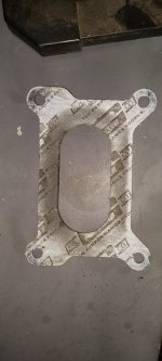

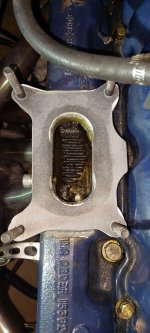

Well i finally decided to try this trick, i leaned out the mixture pretty good and started spraying brake cleaner arpund the base, apparently there is still a leak. I finally take the carb off again (i thought it looked funny earlier but was doubting myself) and it's definitely leaking. I'm thinking over about JB welding my 1" spacer plate to the bottom plate (since the bottom is already JB welded to the head). This way I only have 1 gasket to worry about. Then i can look into getting a real thick gasket for the upper one. Not sure why I can never really get rid of my leaks....

So I lapped the spacer, then copper coated the flange gaskets with 3 coats. The spacer had no rock at all on the carb or adapter plate to the head. Set the transfer slot at .030" and mixture screws at 1.5 turns. Fired her up and it ran great..... but after the choke came off the idle doesn't change from 1800. Finally backed off on the idle screw and got it down to about 750. Played with the mixture screws. About 12.3 AFR and 0.75 turns out on both..... whats happening here? Why can't i get near where I'm supposed to be? Is there too much fuel in the idle circuit causing the idle to be too high? With the .030" transfer slot exposed, mixture screws at 1.5 turns out, and idle at 1800rpm, my AFR was 12.5. I don't know if this helps any.
