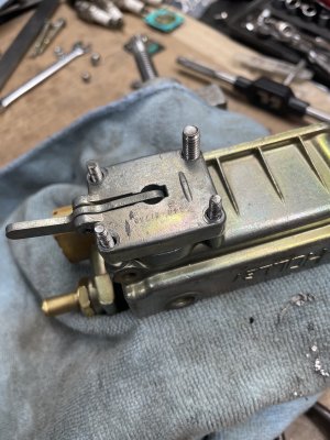

Sooo, I have a Holley 2300 accelerator pump screw that currently has a heli-coil repair in it. The heli- coil has stripped. It is a 12 - 24 threads. It is also a pretty shallow hole. Any opinions on the best way to re-repair? I have some ideas but with all the experience here, I’m sure someone has come across this problem. I would rather not replace the bowl. The carb is zinkchromate plated and afraid it wouldn’t match.

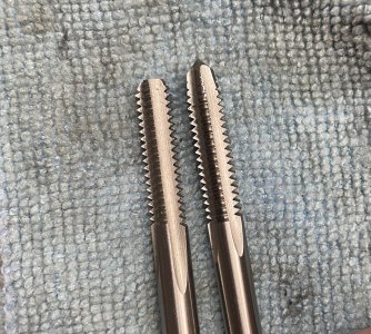

Thanks, I don’t have access to a lathe ☹️. But I did think about either using a “ thread zero”. A pop rivet type thing for making threads in sheet metal. Modifying it to work. As well as just a bolt, modifying the head to be low profile and maybe notched to set recessed in the bowl to help keep it from turning, then JB Weld it all in, but I went with a method to keep the bowel integrity/ not drilling through it. I can still go that direction if needed down the road. I went with one size larger. In hindsight, I probably should’ve checked metric sizes. I got a “straight fluke tap” off Amazon. Ground a little off the nose and used it. Went with studs as opposed to screw to get use of full thread strength, topped off with loc nuts
