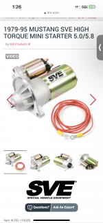

I have 66 with a T5, 136T count flywheel and a 2 bolt starter. I’m looking for a mini starter that fits? Most of the the mini starter I’ve looked around are 157T/164T count, am I missing something? I dont want to buy one till I know what fits that flywheel.
I’ve read that before and there is a no clear answer. People didn’t answer the question when referring to the 136t flywheel. Like does someone know what would fit my applicant?
It is not the tooth count that matters, the pitch is the same ,it is the size of the opening in the block plate and the distance the ring gear is from the that plate 3/4'' or 3/8'' Measure and match up.
